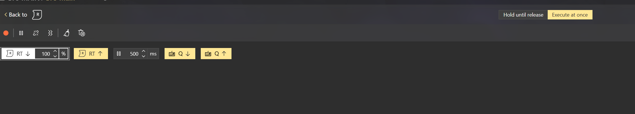

    I am searching all morning the web for the solution to a problem that should be pretty common for a program that indeed just does button presses, but maybe I am missing something. What I want:
    - I press and hold Button A in real life
    - Rewasd should and hold Button A as well just like I do
    - A single (no hold) click of Button B after 500ms of the press of Button A
    I own the full version with all features.
    Is is not possible or just super unintuitive?

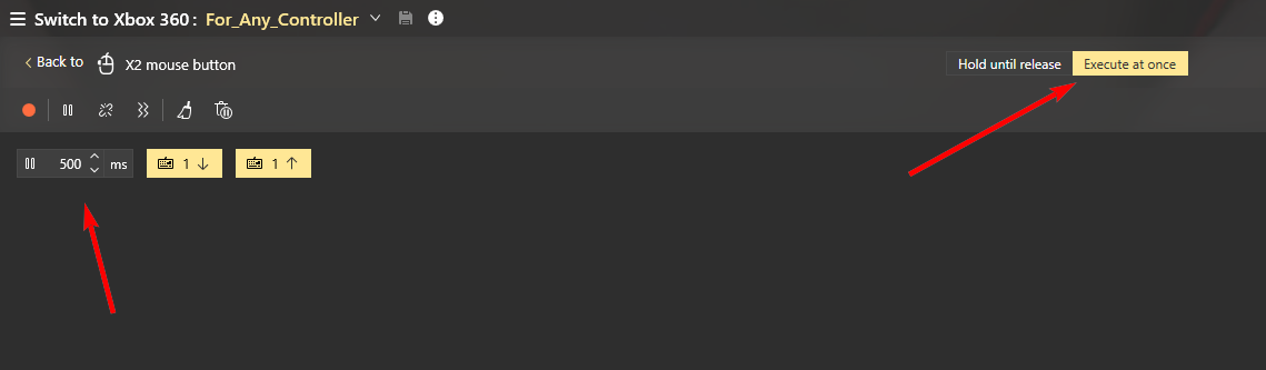

    You need to choose Execute at once mode in the combo editor and add a needed pause between the mapping

      It does not work. It was suggested in other similar posts as well it also did not work for them, no idea why this always is suggested. So there is no option to hold until release in combination with a single click? I don't see why this is not implemented yet, seems wild that a simple feature like that is not available.

        Unfortunately, this cannot be done within one combo.
        You can achieve what you want, but this must be done with the help of activators and two combos.
        You need to map a combo with the key that needs to be held on the Single Press activator in "Hold until release" mode. Then, map the button that should be pressed second on the Start Press activator (add a pause before pressing it in the combo).​
          Thank you that worked!
