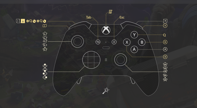

        Send the screenshot of the full reWASD window, please
          This is my current setup the bringing the stick to neutral was not successful. It seems that left stick forward was never interrupted (which it needs to be to retrigger autosprint) and only a left stick back was send on TOP of the physical input instead of replacing it. Any ideas?
            Please click on the name of your config with the right mouse button, open the file location and send us your config.
            You also sent a screenshot of an incomplete window; please send us the requested screenshot.​
