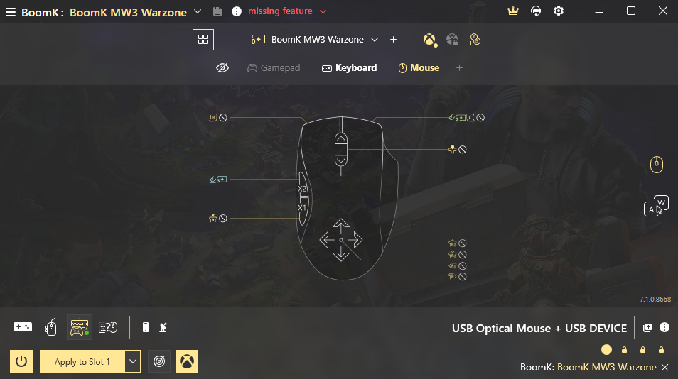

    Hello, i can shoot and zoom with mouse clicks but the movement of the mouse is not working.
    i have bought live time account. do i need more features to buy to move the mouse ingame?
    At the top of the UI, you have a notification that there are not enough features for the config to work.
    If the mouse does not move when applying the config, then most likely you have not purchased the Advanced mapping feature.

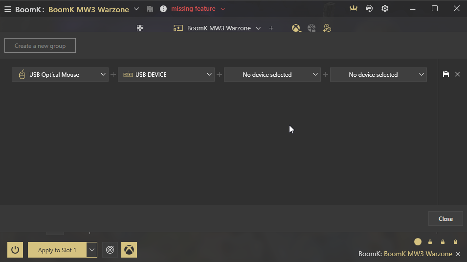

            Please make sure the correct mouse was added to the group using Detection mode: https://help.rewasd.com/interface/device-detection.html
              it is the correct mouse. i am not able to move my mouse ingame after activating virtual controller

                    For the mouse to work as a stick of a virtual controller:
                    • Your license must include the Advanced Mapping feature, or its Trial Period must be active.
                    • The mouse device in the group of devices you are remapping must be the physical mouse you are using (you can test that via device detection mode) and be initialized as a mouse.
                    • Once the config is applied, you must be on the [Main Shift] layer or any other layer where the mouse is remapped to the right stick.

                        According to the info you provided in Discord - you are using a VM.
                        The mouse(on the screenshot of the device group) is labeled as "VMware Virtual Mouse", and that's not how it should be.
                        Try forwarding the mouse from the VM to the PC as a USB device, and not in the way it works at the moment, or use another VM.​

                              i have tried another VMmachine, i choosed the real name mouse and keyboard by rewasd for virtual controller.
                              it is still the same issue...
