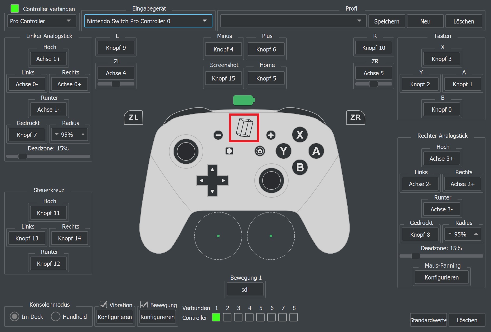

      In Yuzu's controller configuration you can see that the gyro is working, because you can gyro-control the box i framed in red for you:

      In Yuzu, it looks again like a Switch Pro Controller, but the box framed in red is not controllable at all, therefore the gyro is not working:
Name:	Yuzu-Vader3Pro as virtual SwitchPro.jpg
      The same goes for Ryujinx. In Switch Mode, gyro is working, in D-Input Mode with virtual Switch Pro Controller applied via reWASD, gyro is not recognized.
