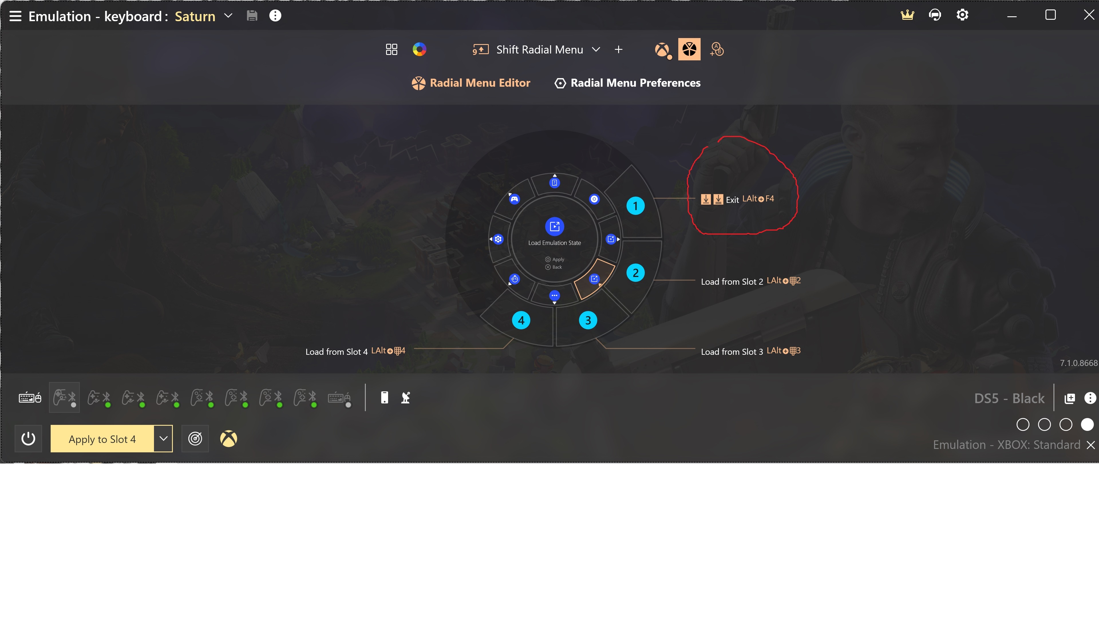

    While playing with Radial Menu - found 2 more bugs:
    1. See attached config. If try to [Save Radial Shift as Default] for this config, ReWASD crashes
    2. You can copy button mapping from normal Shift Layers to Radial Menu ... if mapping have double presses, holds, etc - those get pasted to Radial Menu too (see attached)

          Hello! We have fixed this issue in version 7.2. Please update and let us know if it helped.

            Problem 2 is fixed
            Problem 1 ... no more crashing ... but [Save Radial Shift as Default] does not save Radial Menu itself, it only saves [Shift Radial Menu] controller mapping
            So when new config are created ... only [Shift Radial Menu] controller mapping is pass on ... new Radial Menu is empty
              That's how it should work
