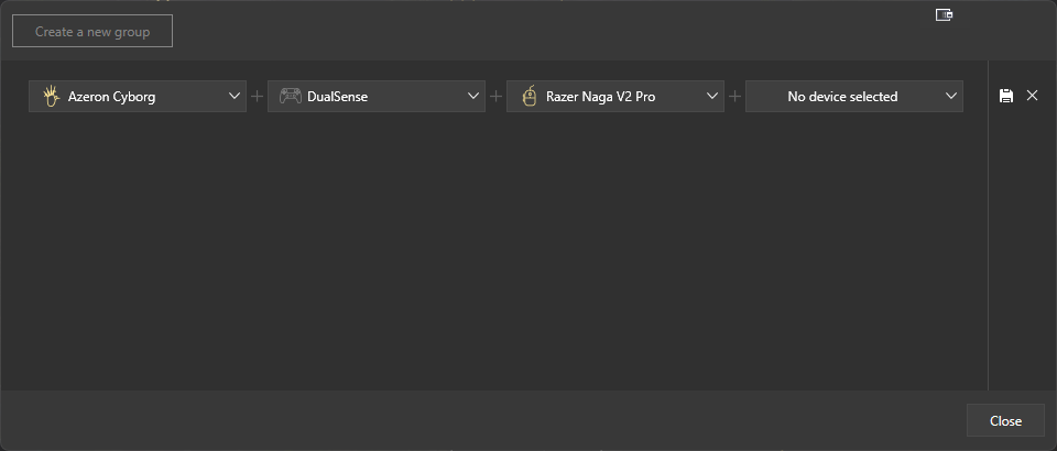

            Click image for larger version  Name:	fetch?id=242158.png Views:	80 Size:	11.8 KB ID:	244555
            Thank you! This is amazing because I’ve been struggling with this issue and didn’t know how to resolve it. I even had to turn off the entire touch sensor screen at one point.
