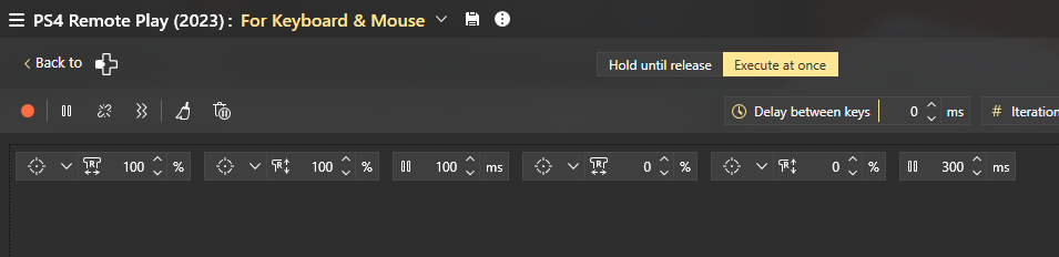

    I'm having issues with binding diagonal stick movements in key combos.
    This is what I have...
Name:	Rewasd Combo's.png
    The problem is there appears to be a delay (Lag) where the up Component is being applied before the right Component and same when returning to 0
    so its like the stick is being moved directly up before moving to the right to attain the diagonal.
    Same when returning to 0, the right will be returned to 0 before the up component is returned to 0
    Is there any way to make it apply both the up and right components instantly at the same time? as if I moved the stick directly to the diagonal...
    Same issue happens with the other 3 Diagonal directions. The diagonal inputs need to be clean and precise. If the game detects a non diagonal direction before the diagonal input is completed
    the game will not do what i require.
    Hi!
    Unfortunately, this is a technical limitation of the combo menu.
      Are there any limits on the number of key inputs that can be applied in a combo?
      A work around may be to apply the diagonal by gradually raising the value of the inputs in each direction with multiple inputs rather than jumping to maximum deflection in 1 input...

              Basically the Game has a sequence where the player has to follow on screen prompts and perform a series of inputs with the analog sticks with perfect direction and timing.
              the number of moves in the sequence ranges from 145 - 256. There are 6 sequences, I've beaten 5 of them legit, but the last 1 is giving me serious grief.
              Hoping maybe Rewasd can handle the left stick while I handle the right manually.
                This is quite complicated so I can't guarantee it will work, however it is best to try it out
                  It will depend on if I can solve the Diagonal Issue and If there's enough room for a 1,000+ inputs. Will definitely be giving it a try.
                  Theres a Trophy + the Platinum hanging on it...
                  Thanks for the Help😊
