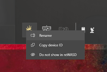

    I've updated to the latest firmware version of the Azeron Cyborg. I have a left-handed version and used the "Show as leftie" option. With hte new firmware, the device is showing as a right-handed cyborg and the option to switch is no longer there.
    HELP!
    We are aware of this issue. And while we investigate it, I can suggest you this workaround:
    Open Preferences → Confirmations → Reminders and enable "Inform about Exclusive mode for Azeron"
    After that, you will be able to choose the layout in the pop-up.
