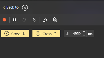

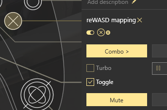

    Actually, you can create a 5-second delay. You just need to put 5000ms manually in the pause block:

    However, to stop the combo, you need to press the same button that started it again.​​
      Oh, thank you! Didn't recognize the Pause-button in plain sight! Thank you!
