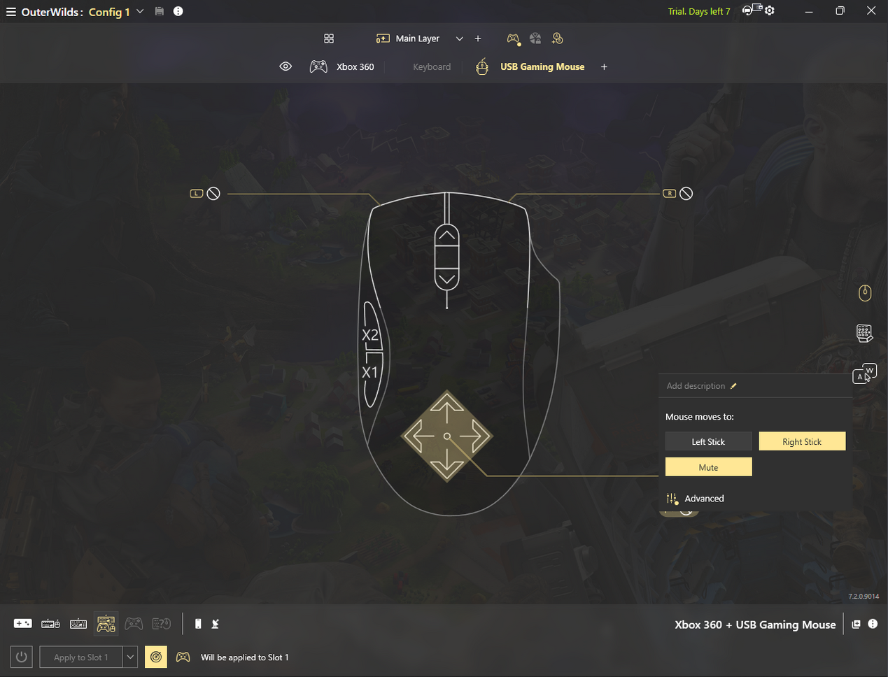

    Been trying to set up Wooting60HE(as XBox controller) + USB Gaming Mouse for use in Outer Wilds.
    Mouse movement is mapped to Right Stick.
    If I use the auto switching feature, when I give focus to the game, the switch appears to activate correctly, however the mouse just acts like a regular mouse and the game keeps changing between M+KB and Controller modes. i.e when I press 'W' to move forward, game goes (correctly) to Controller input, but as soon as I move mouse, it switches back to M+KB mode. This causes mouse lockups during play.
    If, instead, I manually activate the config from the ReWASD ui, then alt-tab into the game, everything works as expected, moving the mouse controls looking and does NOT switch to M+KB
    Is this a bug or am I missing something?
    1. Can you switch Autodetect to your browser and check if the same issue will appear? (use this tester in order to see controller input: https://hardwaretester.com/gamepad)
    2. Send screenshots of the full reWADS window with your config on it​
    3. Please send the config you are using. Your configs are stored here: C:\Users\Public\Documents\reWASD\Profiles I need the correspondent *.rewasd file.​

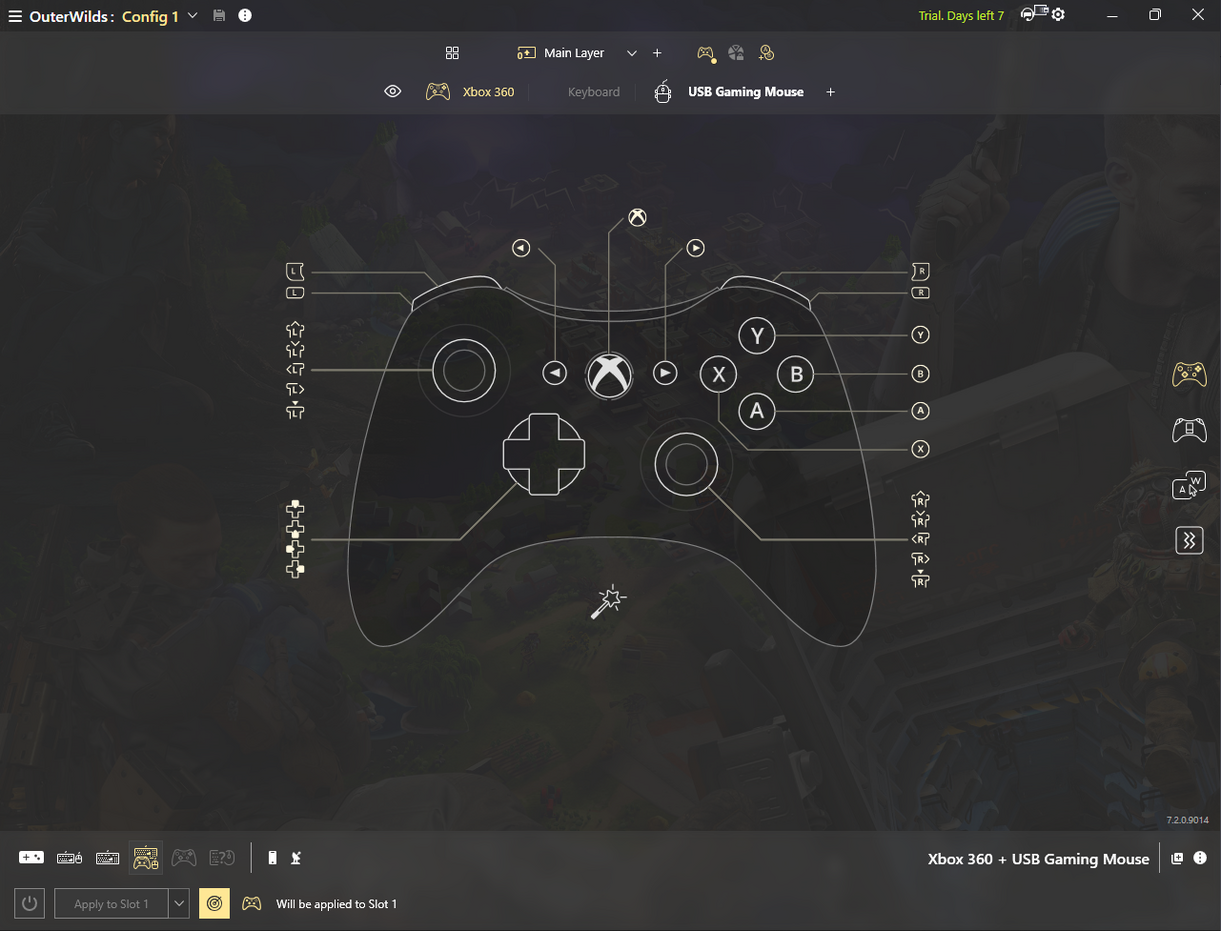

      Hi dude,
      1. In the browser, moving the mouse moves the onscreen right stick correctly. (I think). No way that I can see to check if muting is working or not.
      2. Not sure what you'll gain looking at these, but here they are...

        1. Actually, you can test it with a muted mouse(and I would appreciate it if you did), here is how: https://help.rewasd.com/faq/unmappedmouse.html
        2. You said that you are using a keyboard in the config, why then is there a controller in the group?

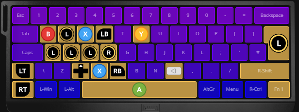

          2. As I said it's a Wooting60HE which is an analog keyboard that presents to the system as an XBox controller. Here is the WIP mapping I'm using...
            Am I correct to assume that the mouse pointer does not freeze when your config is applied via the [Autodetect] feature?
            Also, what output device are you using? The [Magic Wand] menu should show it.

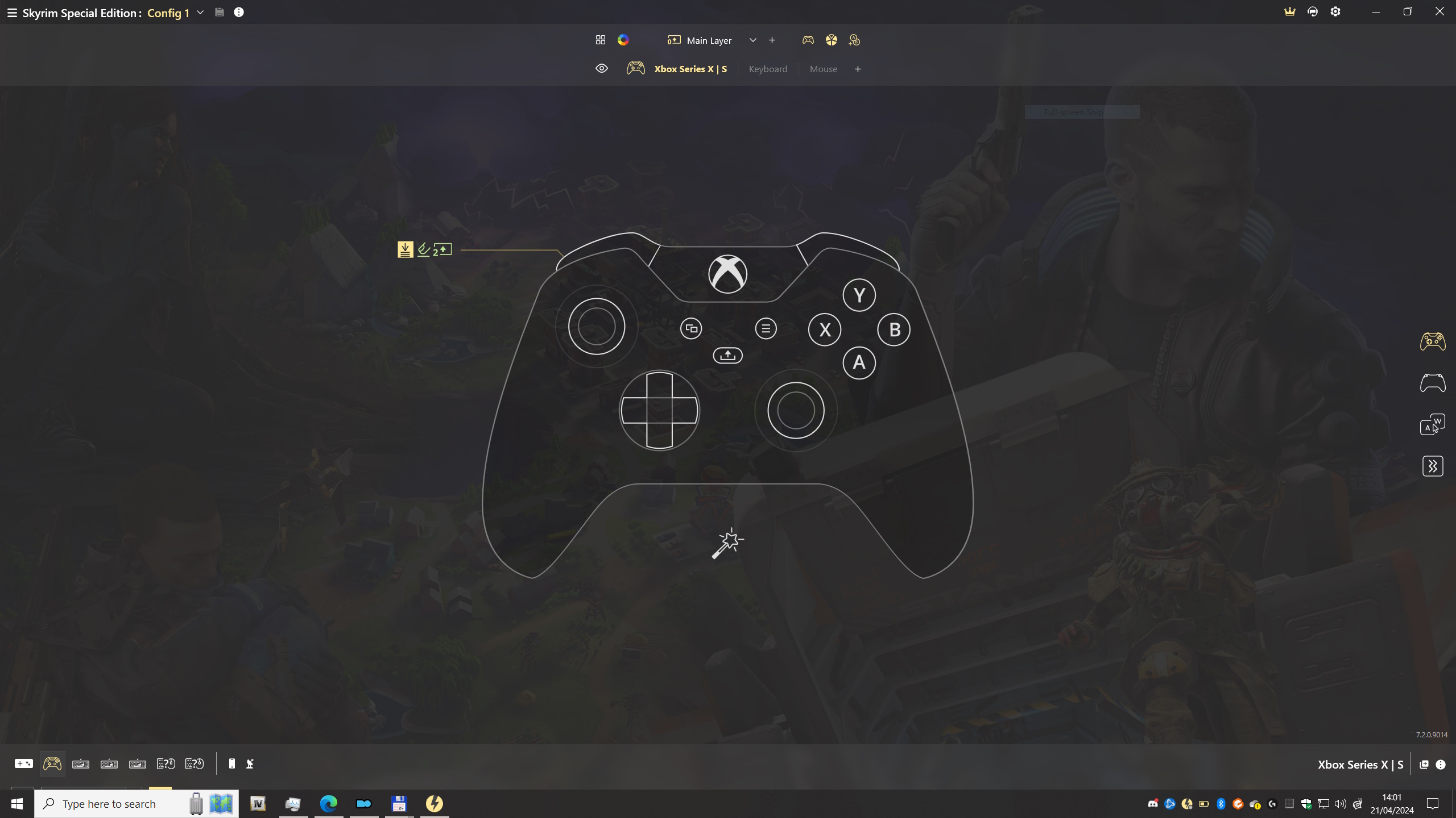

              Hey there, same problem for me. I am with a XBox 360 controller and it doesn't work anymore with Rewasd since the new update. Everything was working right before. Even with no auto detect radial menu isn't showing anymore.
                Hi TheRealBartos
                Please send us a screenshot of the FULL reWASD window with your mappings.
                Also, please send us your configuration. Right-click on the name of your config, open the file location, and send it to us.
                  Here.
                  Also, I realized that the auto detection is working. The mapping works but the radial menu doesn't show up.

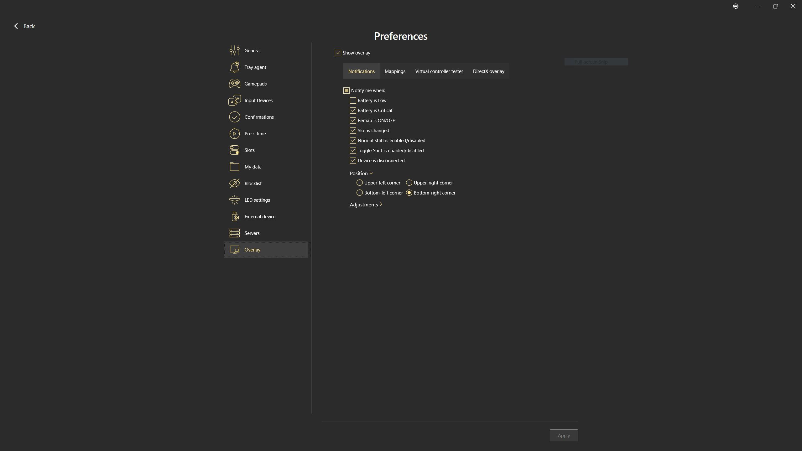

                    Please go to Preferences in the Overlay section and make sure you have overlay enabled.
                      It's enabled.
                        Your config is set so [Radial Menu] would appear only on a double tap and hold of the bumper button made within 300ms.
                        Not tapping fast enough or releasing the button early might result in the menu not appearing.
                        Please ensure you have the correct monitor selected in [Radial Menu Preferences] (an option is available at the bottom of the list).
                          Tell me just one thing. Why was it working before the latest update ? Did something change in the way I use my gamepad ? Stop trying to find thing that doesn't exist and make me dig where there is nothing to find. There is a problem with the latest update. I told you that the mapping is working on the radial menu, it just doesn't show up anymore.
                            It works correctly on our side, so please follow our suggested steps to solve this issue.
                              I have only one monitor.
