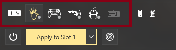

    Hi!
    This will be possible if your laptop's touchpad is displayed in reWASD as a separate device, here:
    You can use Device detection mode to check if that is the case.
    More info here: https://help.rewasd.com/interface/device-detection.html).​
