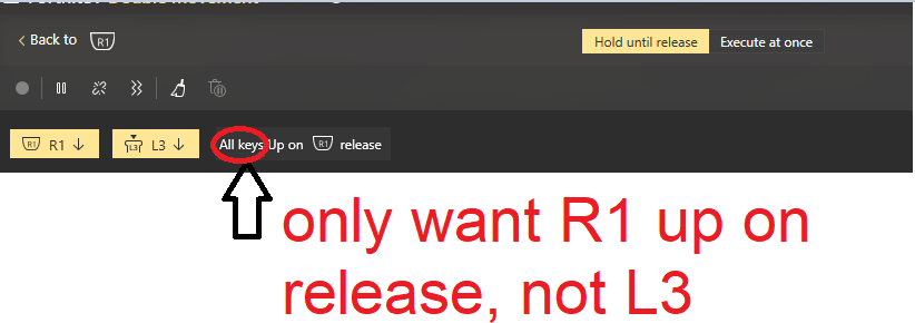

    Basically looking for a way to Press L1 Down until i release the button, but also cause L1 to Press L3 and then immediately release it without letting go of L1, couldnt find a way to do it, any help is appreciated
    Try using activators. Remap [Single Press] to [L1] and [Start Press] to [L3].
      Guess im not following, or i worded it wrong
      Im doing a combo mapping

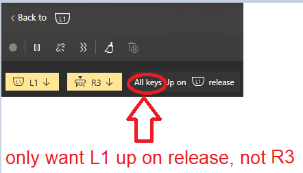

      when i Press and hold L1, i want it to Hold down L1 until i let go, and in that same L1 Button press also Press and let go of L3
        posted picture to hopefully make more sense, i want R3 to be up 10ms after pressing L1 down in this circumstance
          In that case, set the following [Combo] in [Execute at once] mode to [Hold Press] activator and enable the [Turbo] option for it.
          [L1 Down] - [L3 Down] - [Pause 10ms] - [L3 Up] [Pause 60000ms] [L1 Down]
