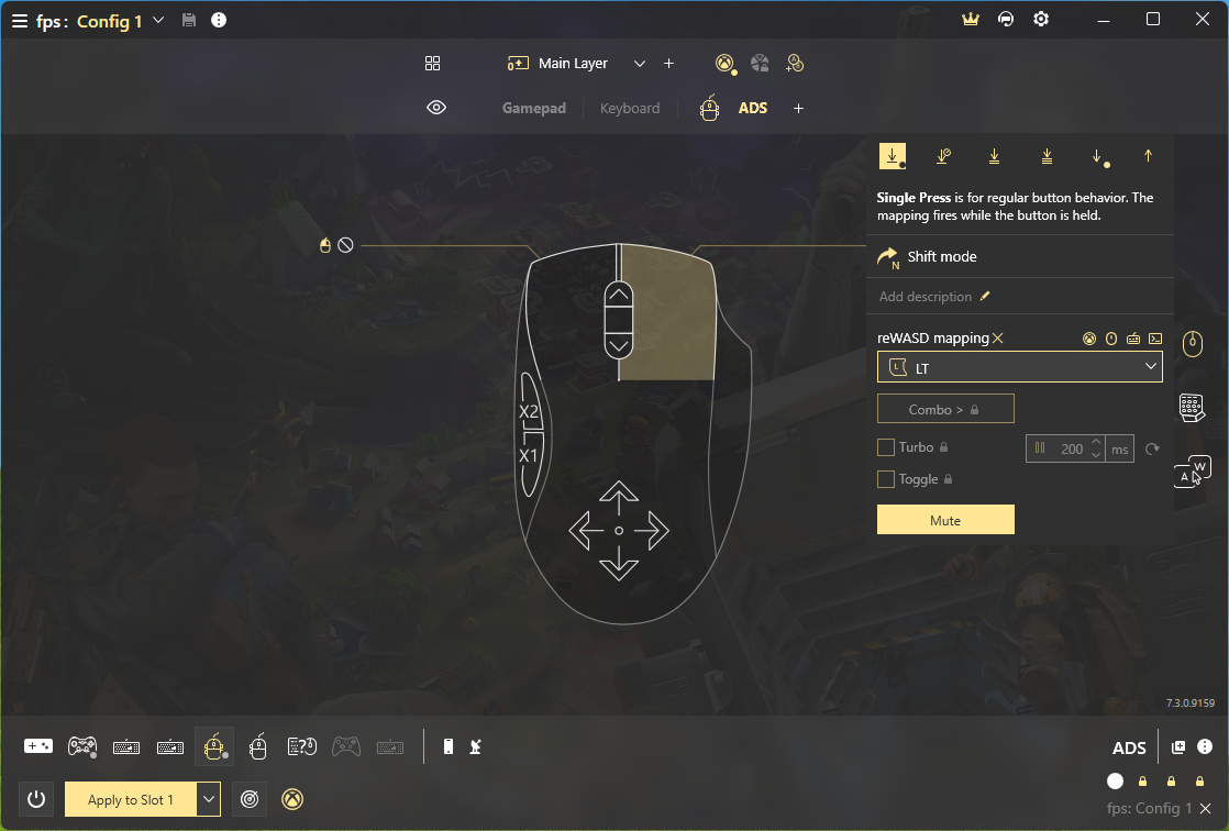

    How can I toggle right mouse as Left Trigger toggled?
    Right now, it activates as expected but pressing any other button causes it to stop/micro stutter.
    Thanks

    The stutters you experience are a result of the different input types your config uses.
    This means that when you press LMB while holding the RMB game switch, you move from controller input to MnK and vice versa.
    To prevent that, you need to use only one input type in your config.​​
      Thank you for the reply
      So as long as I use a physical controller and a mouse, it won't work, correct?
      I thought maybe using shift or layers it might be possible, tbh I still don't fully understand how they function.
      I use left stick mapped as wasd due to a hand injury, without the controller I used a wasd board with my foot.
      My right hand is fine so I use mouse, I can't fully use a controller because of the left
        You can use both of those physical devices simultaneously; just make sure you group them and map them as the same virtual input type.
