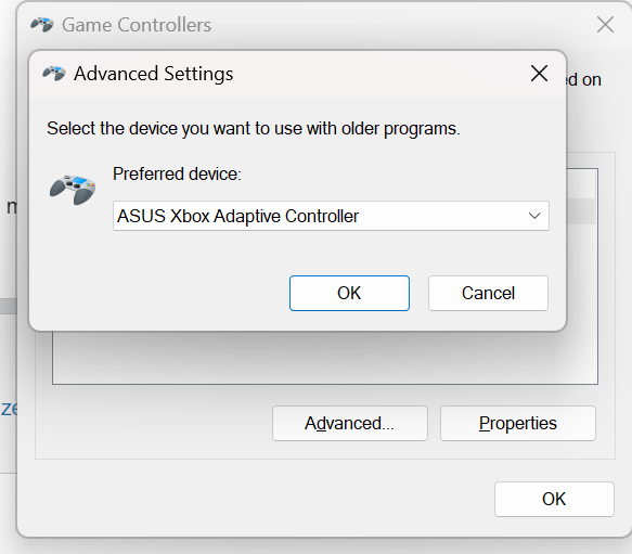

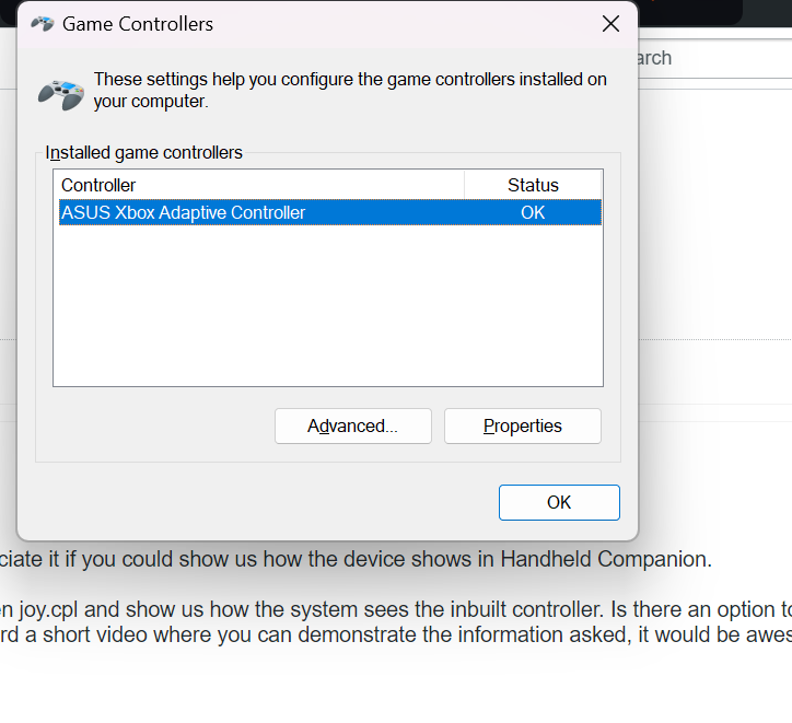

      We would appreciate it if you could show us how the device shows in Handheld Companion.
      Also, please open joy.cpl and show us how the system sees the inbuilt controller. Is there an option to change the controller input?

Name:	Screenshot 2024-07-28 221704.png
ID:	243483Click image for larger version
Name:	Screenshot 2024-07-28 222754.png
        this is what shows on the joy.cpl.
        regarding Handheld companion, it did a whole mess with my handheld and better un installed it.
        but hopefully this helps
          Thank you for the information provided.
            Please let me know if you need any more details
