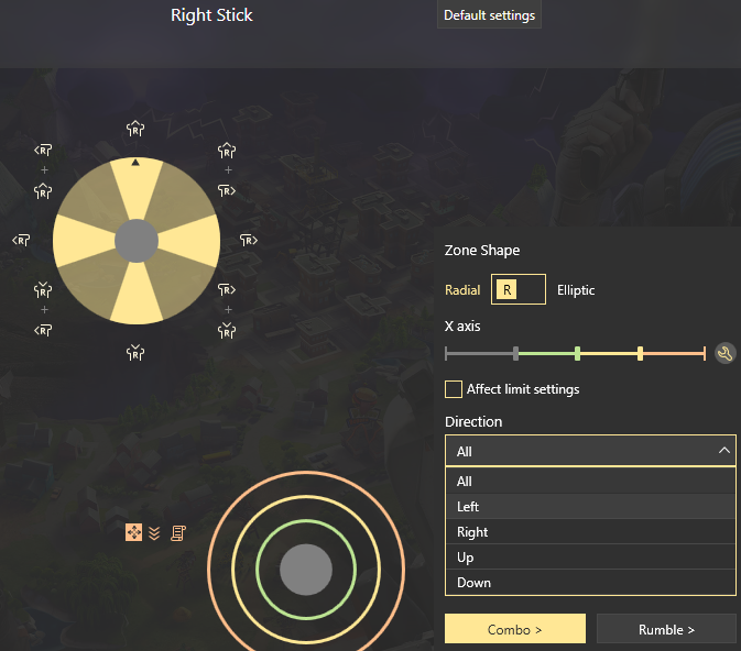

    i made combos for the back paddles on my Xbox elite controller but now I want to use the right joystick to map more combos like to the left,right, up and down, axis but when I use the right stick advanced settings and finish creating a combo, it maps the combo to all the sides of the right stick after I'm done recording, even when erasing, so is there a way to individually assign more combos to the right stick so it functions like buttons?

        If you want to assign different combos to the stick movements in different directions, you need to select the stick direction from the dropdown list and assign mappings to the directions you need. You also need to remove the existing mapping assigned to "all directions."
          Thank you! It worked.
