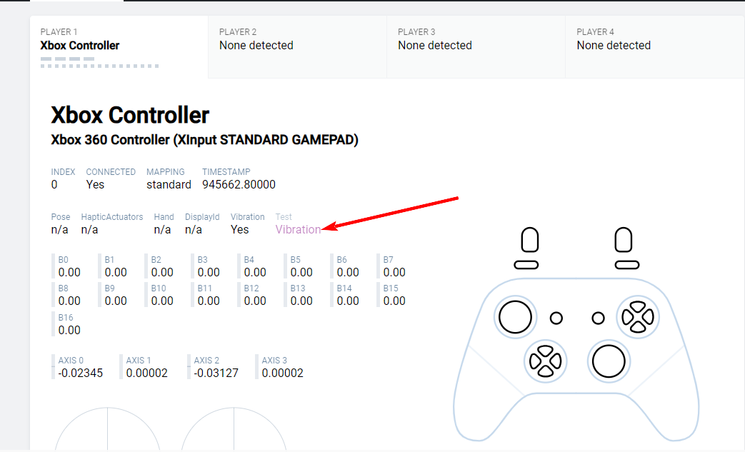

            I have no issues with Rumble either. Please apply the config and check the Rumble in this tester. Also, please show us your Rumble settings
              Rumble is not functioning on the Gamepad Tester website. I used the default “Switch to Xbox 360” profile without making any modifications.
                my controller is a ds4 v.2 CUH-ZCT2E model

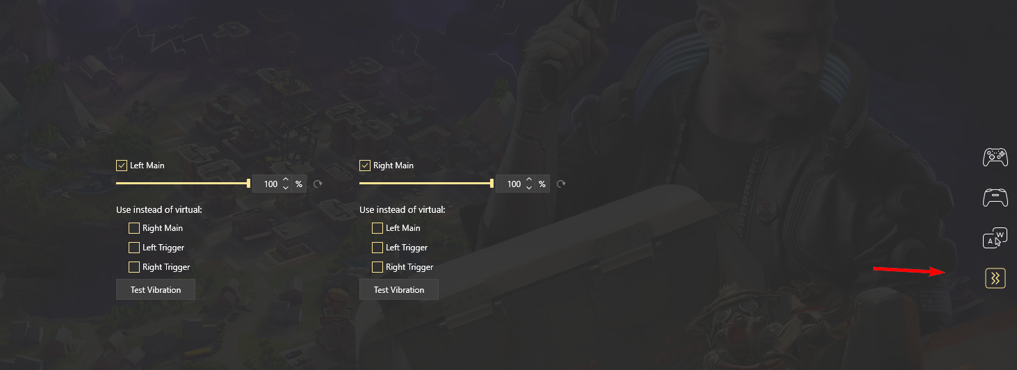

                  The tester has Vibration option for Xbox 360. I've checked myself. Also, open reWASD rumble settings and check the vibro there

                    It appears we are having a repetitive conversation; I have tested the site, and the outcome remains unchanged. I've attempted to adjust the reWASD rumble settings to no avail. For those who haven't read the initial post, here's a brief overview of the issue: The rumble feature does not function with reWASD, despite no alterations on my part. I am utilizing the default Switch to Xbox 360 profile provided by the app. Interestingly, the rumble works without reWASD and is operational with DS4Windows. It's great if it works for you 👍, but since it doesn't work for me, I've created this post.
