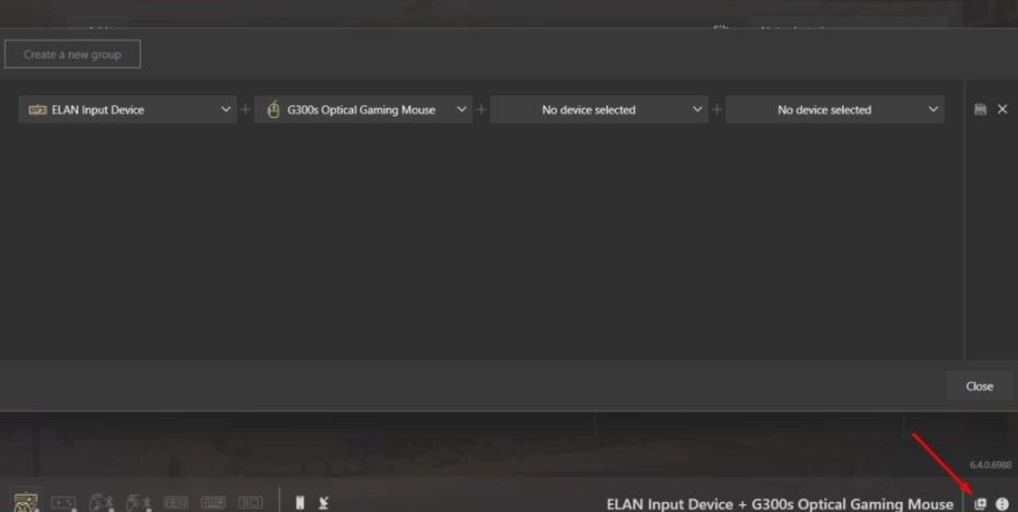

    1. Send screenshots of the full reWASD window with your mouse and keyboard configs on it
    2. Show me your group like here:

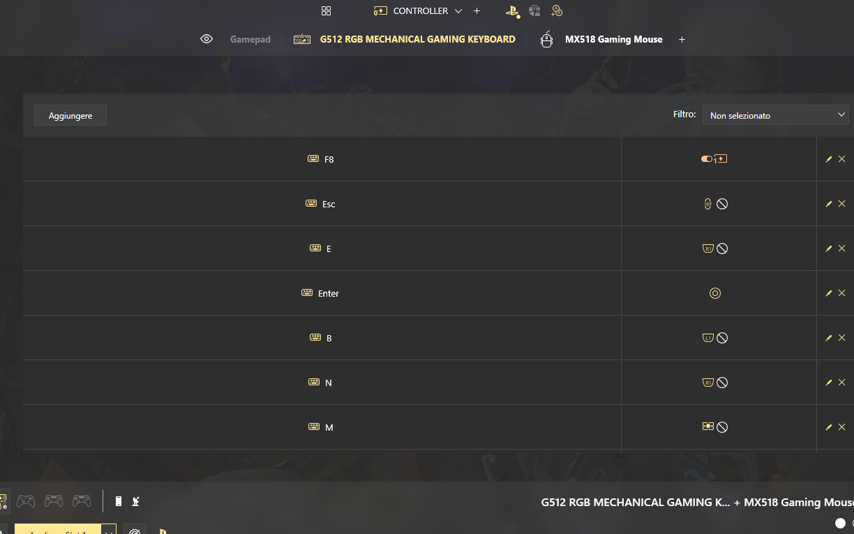

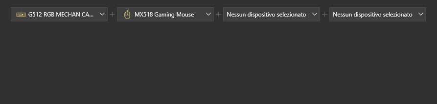

      Thanks for the answer.. This is my config:

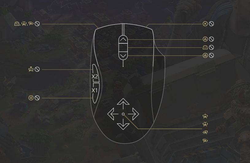

          sorry.. u can find out them below.. But i noticed that when i press "APPLY" my entire PC seems to "freeze".. can't use windows button, can't switch to other app.. it only get back if i press ctrl + alt +can to stop te emulation..

            The mouse does not lock and the input in the game switches because you do not have Mute on mouse movements.
            Enable Mute for all mappings where available.
              ah ok, not it works !! Thanks !!!!
