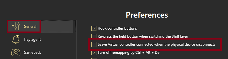

    Also, you might need to turn on this option:

      Checking or unchecking that option in preferences didn't change anything for me.
