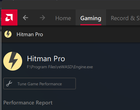

    I believe REWASD is interfering with AMD Adrenaline game detection.
    Somehow AMD Adrenaline Software is detecting REWASD as a game. Sometimes it creates a profile called hitman pro for REWASD.
    Its very strange. I just know something funky is up with Adrenaline and Game detection. It may not be REWASD at all but a driver issue.
    I updated to latest version of REWASD.
Name:	Adrenaline REWASD.png

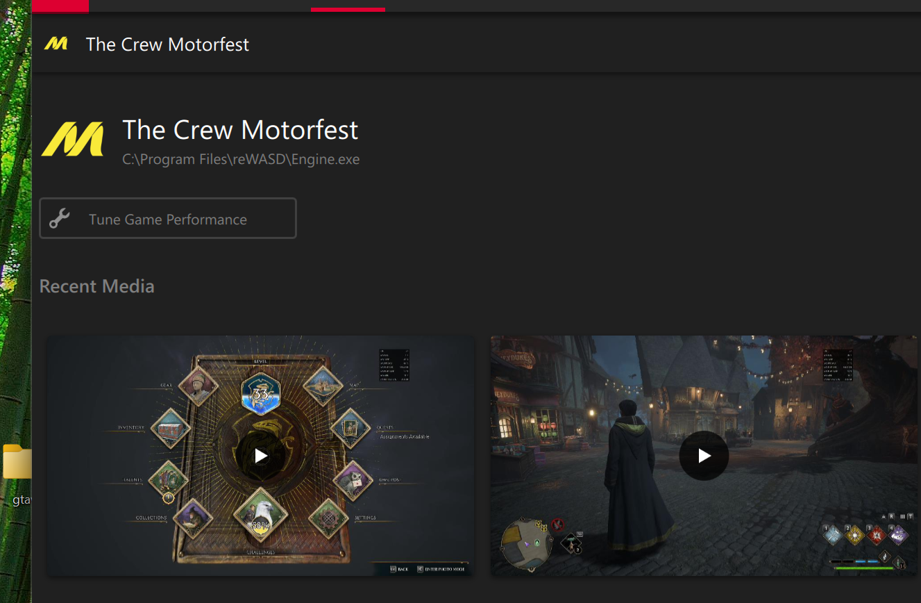

      Hello, i have the same problem:
      I've also seen the "Hitman Pro" issue and found a reddit thread describing it: https://www.reddit.com/r/rewasd/comm...ng_hitman_pro/
      Maybe some combination of a recent ReWASD version and AMD driver update?
      Thanks in advance.

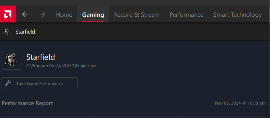

        Could you please clarify the exact reWASD version you have installed?
          I can confirm this Hitman Pro issue myself. Currently running rewasd 8.0.2 and Adrenalin 24.20.11.01 still detects it as Hitman Pro, which appears to be some random unrelated application
          I personally don't mind this much, though, and didn't bother reporting it because I assumed it was something on AMD's end going wrong. As far as I know, Adrenalin essentially "guesses" what the running application is, and in most cases it gets it right. It just doesn't in this situation
