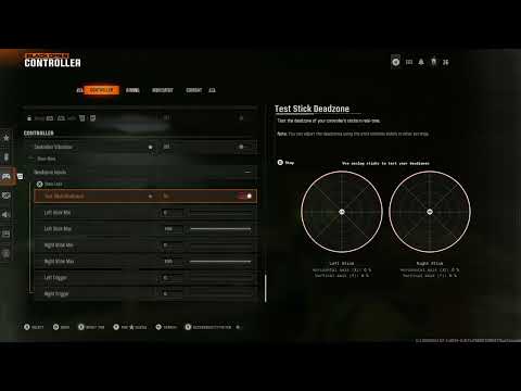

I'm having a problem where if I have mouse set to right stick, when I move my mouse it constantly resets the right stick to default position, is there anyway to fix this? (video for example) https://youtu.be/cEGMZI0hfR0
stick keeps resetting.
That's how it should be. If you want the stick not to return to the center position, you can try using the Radial Menu mode, which can be enabled in the Advanced Mouse settings.

Unfortunately, we do not have an alternative to the Radial Menu mode suggested above.
It should be noted that sticks do not work like mouse does. To turn the character from side to side quickly, you need to hold the stick for some time at the maximum point of deflection. Which, in case of mapping the stick to physical mouse, is equal to slowly, but consistently, moving it in a certain direction.
Please check out this video, we explain all the settings you can change (both in-game and in reWASD), and show how exactly the mouse remapped to a stick is different from the regular mouse.
Also, here's the post where we describe all the settings that you can change to make mouse movement better.
