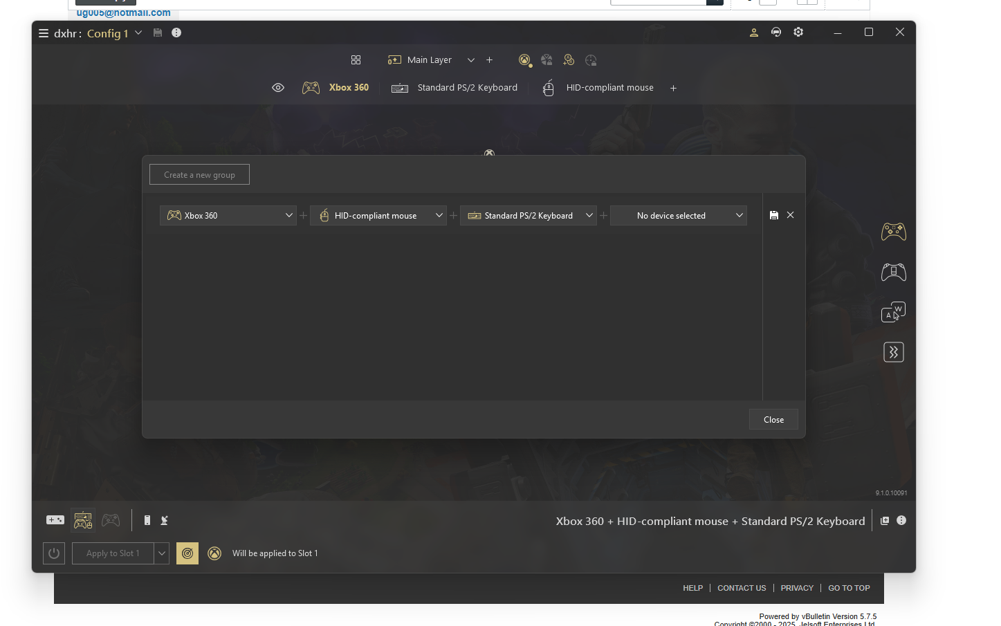

        Also, please send a screenshot of the device group like here:

          ok, tried my best to attach what you asked for. Plz let me know if I made a mistake with the attachments, and thanks.
            It looks like you mapped the right stick to the mouse, but if your goal is to aim with the mouse, you need to do the opposite —
            remap the mouse to the right stick.
            Also, try creating a new group that includes only the mouse and the controller.​​
