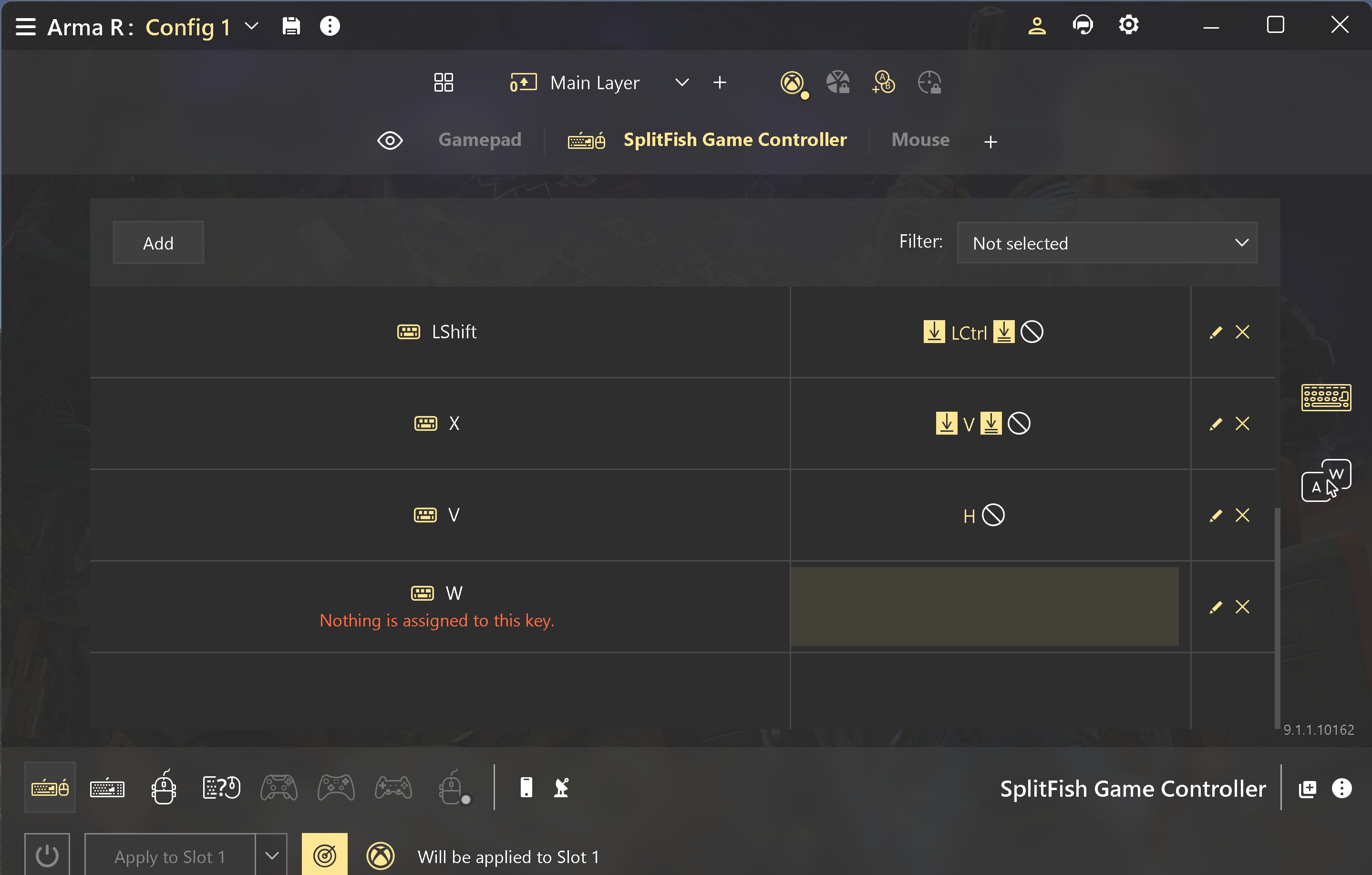

    So I play Arma reforger. I like to fly with my dual analog XboX type (Guilikit kk3) and use splitfish and mouse when I'm on the ground with my gun.
    Issue I am having is when I try to make a config for the Xbox controller, it changes the config on my splitfish controller.
    So even though they appear to be separate configs, they seem to be linked.
    REWASD calls my Xbox (Guilikit kk3) controller (Xbox 360)
    It calls my Splifish Frag FX fragchuck (Dualshock 3)
    Is there a way I can separate them completely?
    Thank you.​Click image for larger version

      Hello there.
      They are not grouped.
      However I figured out how to do it. I flipped the switch on the frag chuck dongle to emulate a keyboard instead of it emulating a controller and it recognized them as separate devices.
      So now I have my dual analog set up for helicopter/on foot
      And my Fragchuck and mouse set up for just on foot, although it can do both but analog on the chopper/vehicles is much better.
      Thank you though.
        I do have another question though. In this section of REWASD, Is there any way to create an analog type setup for the frag chuck on the WSAD stick so the WSAD has sensitivity zones?
        Thanks again.​
          You can set up different zones for the stick in Advanced settings and assign different keys to simulate analog-like behavior.​
