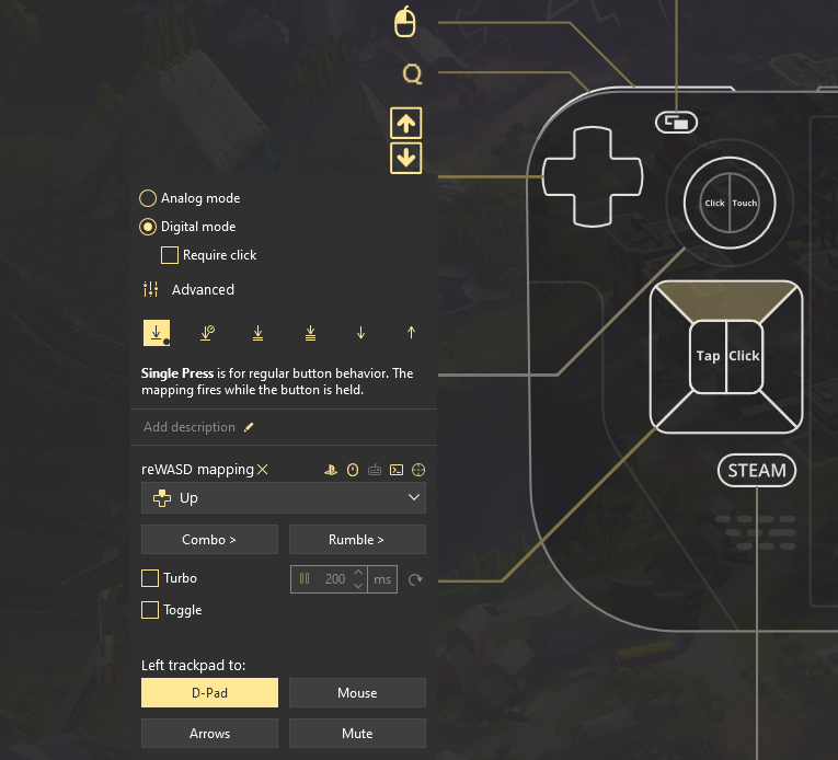

    5. Yes. In reWASD you can assign a ready-made D-pad mapping to the edges of the trackpad, and the central zone can be separately reassigned to another mapping (both tap and click).
    Click image for larger version  Name:	image.png Views:	12 Size:	280.8 KB ID:	245425​

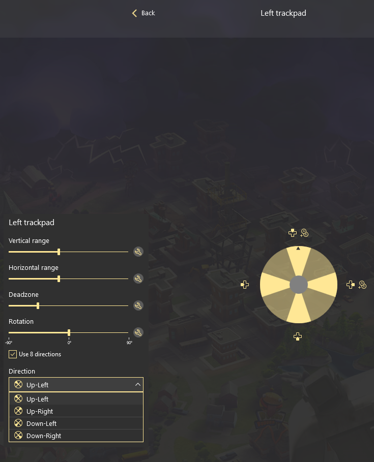

      #5. OK, so I cannot have 8 separate bindings on a dpad with central 9-th button?
        #2. Autohotkey should detect input that is emulated in reWASD, but not vice versa. However, in the future, we plan to make it so that virtual input that is emulated by software such as Autohotkey is detected and can be processed in reWASD,
        #3. No. reWASD can emulate the following virtual controllers: Xbox One, Xbox 360, Dualshock 3, Dualshock 4, Nintendo Switch Pro.
        #5. You can enable the "Use 8 directions" option in Advanced trackpad settings and assign mappings to diagonal directions by enabling the digital mode on a trackpad. Moreover, you can use shortcuts to get additional mapping options.
          And I guess, using joystick on a trackpad with 8 different bindings won't work as zones are triggered together with actual directional binding right?
            I have clarified the information and edited my previous post. Please check it out.
