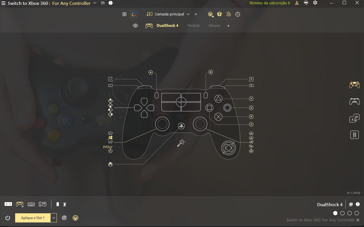

    I have 2 controllers that Windows always recognizes as 'Controller (Xbox 360 for Windows)' in joy.cpl.
    Today was the first time I went to use reWASD. So, reWASD was already running, and then I connected the USB dongle in my PC to use my wireless controller. But as soon as I connected the USB dongle, reWASD showed me the following pop-up: 'DualShock 4' - Disconnected, and my USB dongle stopped working at that moment (the red light turned off, and then I connected it to another computer, and it doesn't work anymore).
    Since then, my controller has been automatically recognized natively as DualShock 4, even being able to 'emulate' an Xbox 360 controller. Now every time I connect my controller, even with reWASD uninstalled from the system, it is recognized as a PS4 controller (even by Steam itself).
    I need help ;( I have uninstalled and restarted multiple times, but it doesn't return to the original state of the Xbox 360 controller. Since the dongle no longer worked, I connected it via cable and it always recognizes it as DS4

    What you are describing is something very strange, and it is unlikely that it is caused by reWASD.
    Our software affects your devices at the software level (not hardware) and only while the remap is enabled. This means that if you connect the controller to another device, the reWASD changes will not work. Likewise, if you removed the reWASD driver from the system when uninstalling the program.
    It seems to me that the key to the mystery should be sought in the controller or dongle itself.​
    However, could you please specify the model of the device that is causing the problem and its dongle? Ideally, please indicate where you purchased the device and also send a photo of the back of the gamepad.
    Thanks in advance.​
