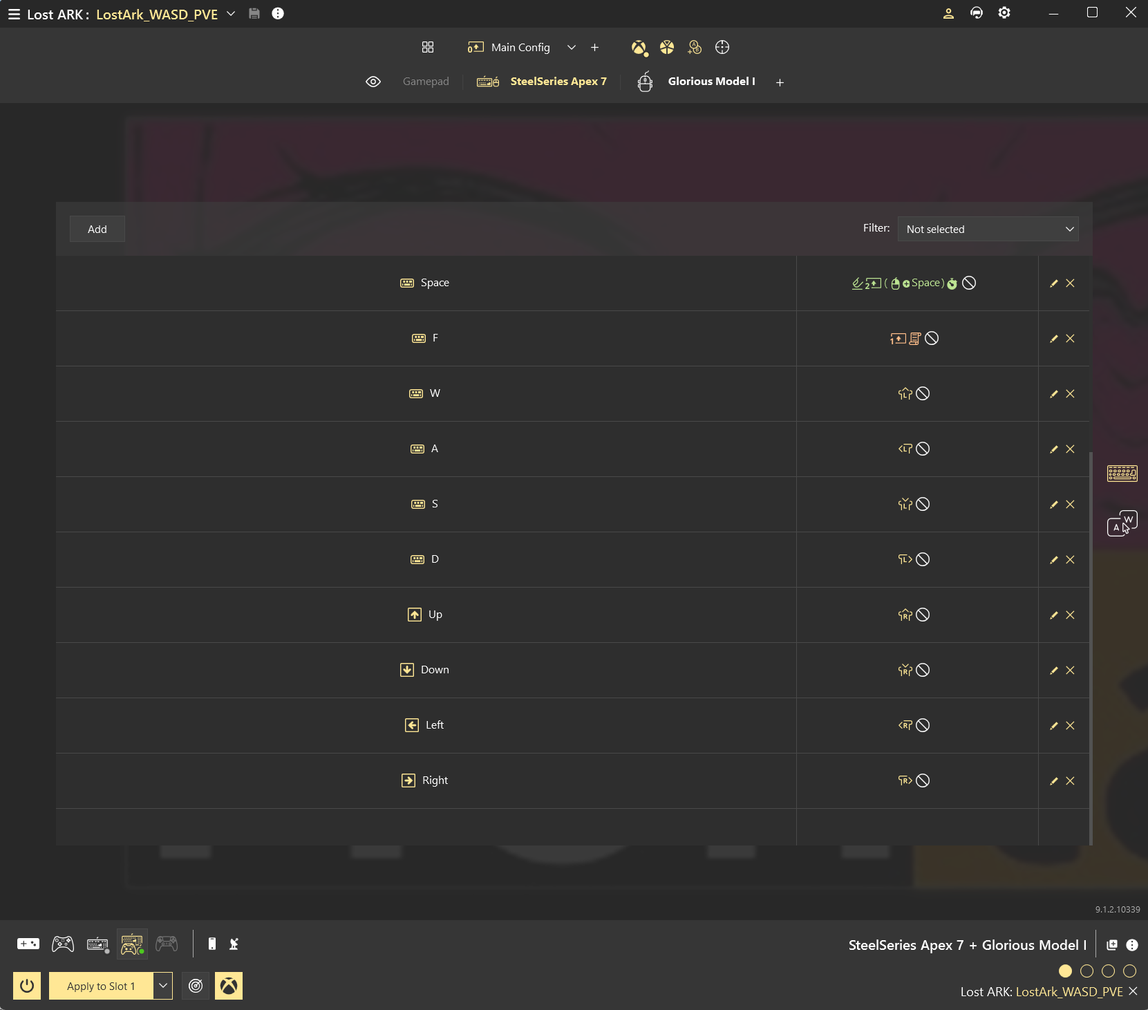

        edit #2: I got physical controller to work 100% of the time, even with reWASD enabled. however reWASD RS is still not working no matter how i map it ... I also checked steam controller settings, and it is enabled and turned on for the virtual controller (xbox one)
          Screen shot of my current setup for WASD and UDLR for LS / RS:
            Hi. The screenshot you provided only shows the keyboard mappings for the virtual controller. Please also send us a screenshot from the controller mappings section for your physical device.
            Also, please check if both the virtual and physical controllers work correctly in the tester, both with and without the applied config.​
