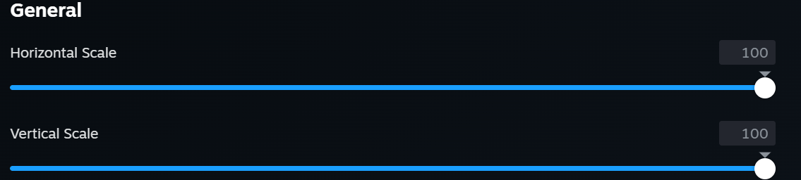

    How can I adjust stick sensitivity using reWASD? I'm familiar with Steam Input. There, in joystick settings, it's possible to adjust vertical and horizontal scale. This way I can manage right stick sensitivity for aiming.
    Is there a similar option in reWASD?

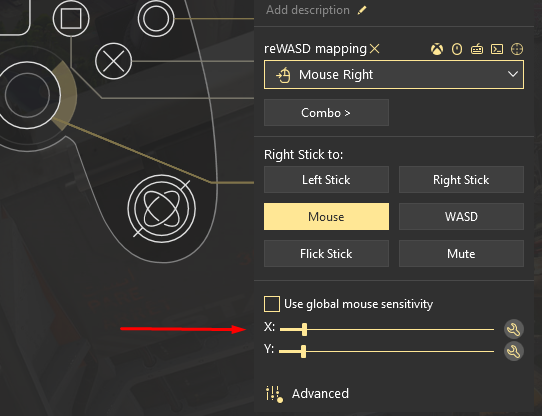

    In reWASD you can adjust stick sensitivity by remapping your stick to Mouse. Then you will see the X / Y sensitivity sliders where you can set different values​.

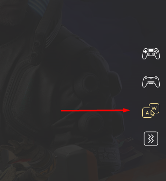

      I tried that, but the movement feels somewhat jerky? It's a mix of normal smooth movement with sudden spikes, where the pointer randomly speeds up every few seconds (around every 1–5 seconds). It happens even more frequently when I'm moving at the same time (using the left stick). Different response curves help reduce it slightly, but they don't completely eliminate the issue. Is there any solution to this?

        You can find more sensitivity settings on the right side under the icon — try adjusting them to see if it improves the smoothness.

          oh i adjusted it and it works great! great!
