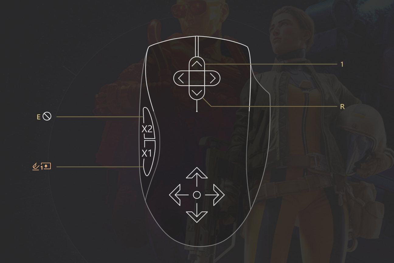

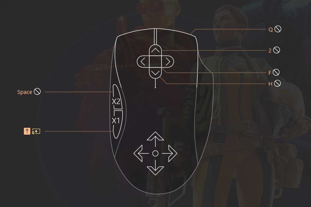

    Hi ReWASD-Team,
    I ran into a technical problem with my latest config.
    Because of physical limitations (I use ReWASD purely for accessibility features and wouldn't know what do to without it! ♥) and need to make the most out of my mouse buttons, so I use a shift layer on my scroll wheel.
    Scroll Up -> Weapon 1
    Scroll Down -> Reload
    Scroll Up (Layer 1) -> Weapon 2
    Scroll Down (Layer 2) -> Unequip Weapon
    Main Layer isn't muted to keep basic scrolling on the game's map intact.
    And this actually works ... sort of.
    When I hold down my shift button (X1 / Mouse 4) and move the wheel by one "click" and then release both, my computer will receive both inputs.
    So, instead of grabbing my Weapon 2, the animation stops immediately and my character pulls out Weapon 1.

    I can circumvent the issue by holding my shift key longer. However, this feels very unnatural to do and can get pretty messy in stressful game situations.
    Strange thing is: When I set up the shown configuration in Razer Synapse by using Razer's own "Hypershift", it works perfectly.
    But this will prevent me from doing any additional remaps with ReWASD, which is, unfortunately, a No-Go for me.

    Main Layer isn't muted to keep basic scrolling on the game's map intact.​
    But something tells me this is the source of your issue. Might tell more once the screenshots are up.
      Pictures are reuploaded – it should work now.
      I also just tried muting the scroll wheel on my main layer, but unfortunately, the behavior didn't change.
      It's like ReWASD still registers the main layers input, even though I release the shift key the very second the scroll step is completed. Like I said – if I hold the shift key a little while longer, everything goes smooth.
        Screenshots and despription suggests that you are making another scroll input after releasing [X1], which is the only reason you'd get that 1 right after the 2 in this config.
