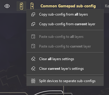

    Iam trying to map the left gyro to lean with a roll to the left to trigger key Q and roll right to trigger key E. The right Gyro should work as a mouse input with the + button to turn gyro on and off. Is it possibe to have independent gyro control?

    If you have both Joy-Cons grouped and they appear as a single gamepad (a single gamepad subconfig is displayed at the top), you can click "Split devices to separate subconfigs." This will allow you to configure both gyros differently.

      Hi, but how to get them working together. Now i can only choose one controller either the left or right one. Thanks in advance
        Hi. If you want to use your device as you described above, then we have offered the only possible way.
          It works i forgot to hit apply. Thank you very much
