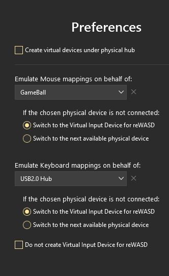

                • Ensure that your physical mouse and keyboard are selected for remapped output at [Preferences > Input Devices].

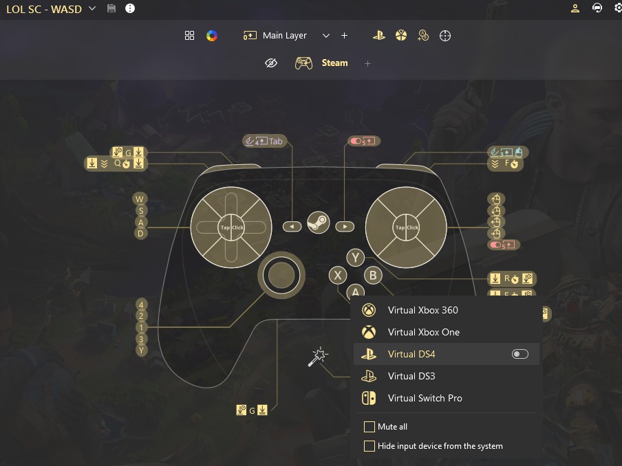

                      It's possible the game is confused about which input to use because, in addition to emulating virtual Kb&M, you're also emulating a virtual DS4 in reWASD.
                      Try the following:
                      Click "Magic Wand" under your controller image in reWASD and disable virtual DS4 emulation (no virtual gamepad type should be selected).
                      Then apply the config and test it in-game.​
                        Your screenshot of Preferences > Input Devices shows two things: you are not using the latest version of reWASD (please update), and it doesn't seem that you have your physical mouse and keyboard selected there.
                        Just as 1ncorrect mentioned, some games can bind to a specific input device (usually the first one sending inputs while the game is running) and ignore all others. If you you don't have your physical keyboard and mouse selected as output devices in reWASD or have a controller sending any inputs (the virtual one in this case), it can lead to what you are having.

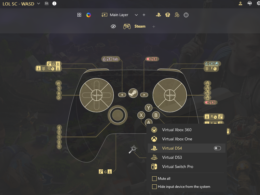

                          I did the magic wand now and selected this:

                            We cannot see from the screenshots what version of reWASD you are using (is it 9.1.4?), nor can we verify that you have chosen the correct mouse and keyboard devices in the settings.
                            [GameBall] is likely a gaming trackball mouse, and [USB2.0 Hub] is unlikely to be the keyboard you are using unless it has a built-in hub or is connected via a hub or adapter.

                              You are right that is my mouse and kb
