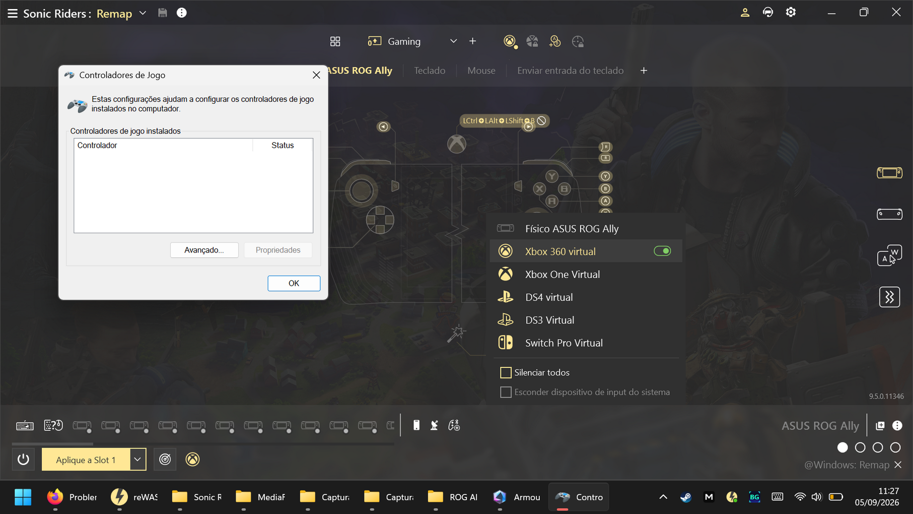

    Hi guys! I'm having those problems on my ROG Ally and I spent several days measuring it and trying to find workarounds with AI.
    I basically have two problems: after waking the device (the power button) the virtual controller doesn't work anymore (the controller gets grayed out in reWASD and it disappears from joy.cpl). Clearing reWASD data on settings does solve it, but it happens again after putting the device to sleep again (which happens all the time because it's a handheld). The second problem are those "ghost controllers" that keep appearing as I use the device.
    My current workaround is to just not use the virtual controller, works but quite limiting when it comes to remap.

    1. Clear data in reWASD. The virtual controller works: joy.cpl lists
    "Controller (XBOX 360 For Windows)", Steam Big Picture works, games work.
    2. Press the power button, then wake the device up.
    3. The controllers in the reWASD UI are greyed out, the virtual controller is
    gone, and joy.cpl is now completely empty.
    Step 3 is the worst possible combination: the physical pad is still hidden
    (the profile has "convert to virtual" on), but the virtual one is not there. So
    there is no usable device at all — not even Start responds.
