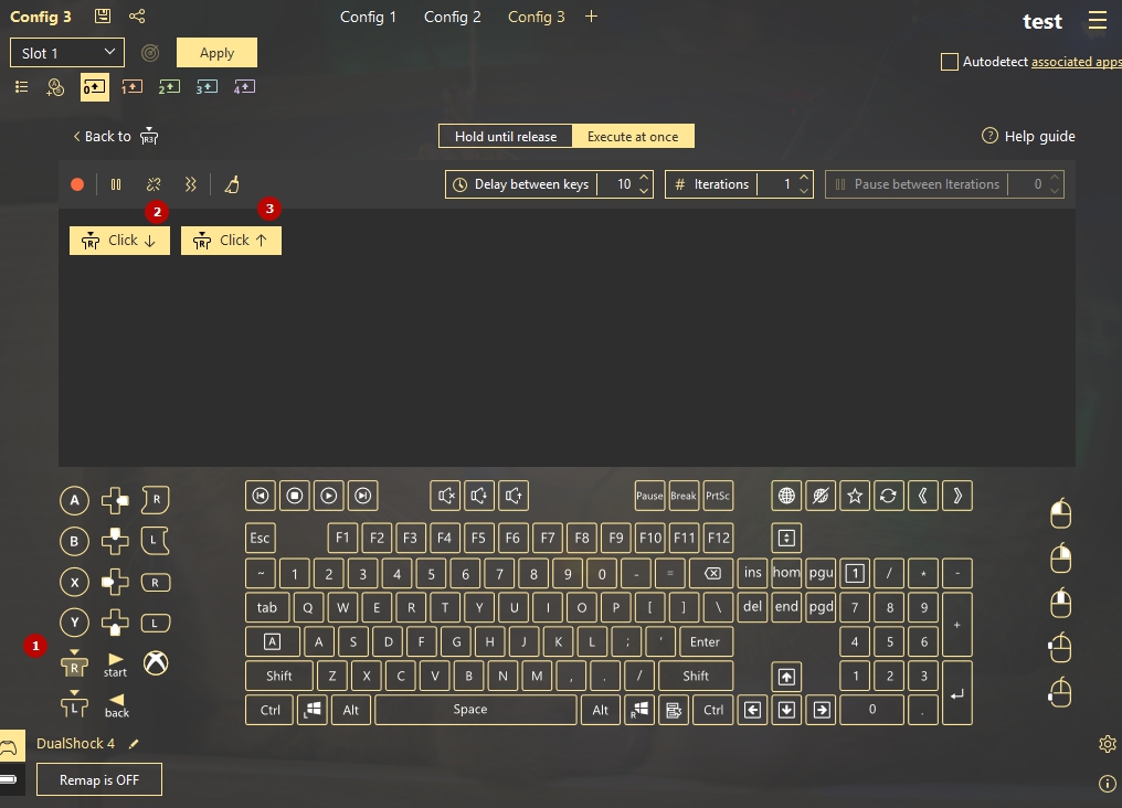

    You won't be able to use recording for controller buttons, you need to click the needed one from the bottom-left. On the screenshot below, I've chosen Right-Stick-Click (1). Two nodes were added to the sequence, but they are not the same. (2) stands for Click-Press and (3) for Click-Release:

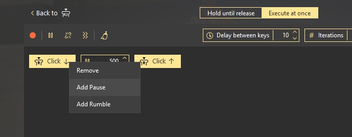

    Now, I can for example add a pause between press (arrow down) and release (arrow up). The combo below does the following: click will be pressed and released after half of a second:
