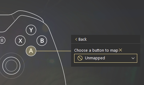

        If you unmap the button, it won't work like "A", but according to your first post you don't need its native behavior but the keyboard combo. If you set a combo and unmap the button, the game will see only keyboard actions you need. To unmap, go to Gamepad mappings and choose "Unmapped" from the drop-down list.

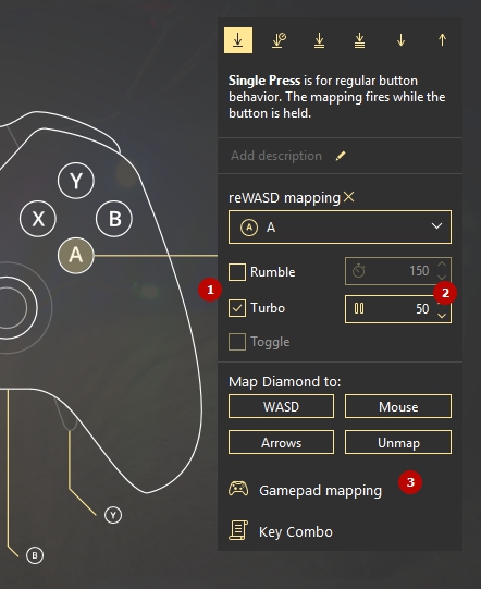

            Oh, I see. You need "Turbo" checkbox to do what you want and adjust the pause between press-release emulation.
            Follow these steps:

            1. Open "A" mapping panel, check Turbo option (1)
            2. Adjust the pause between emulates presses (2) - 50 ms as I understand from your previous message.
            3. Go to Gamepad mapping section (3) and choose "Unmapped" there: Click image for larger version

            This way, while you press and hold A button, it fires A-A-...A.
            If you need Space to be working this way, just choose it in reWASD mapping section. Steps 2 and 3 are also required.
