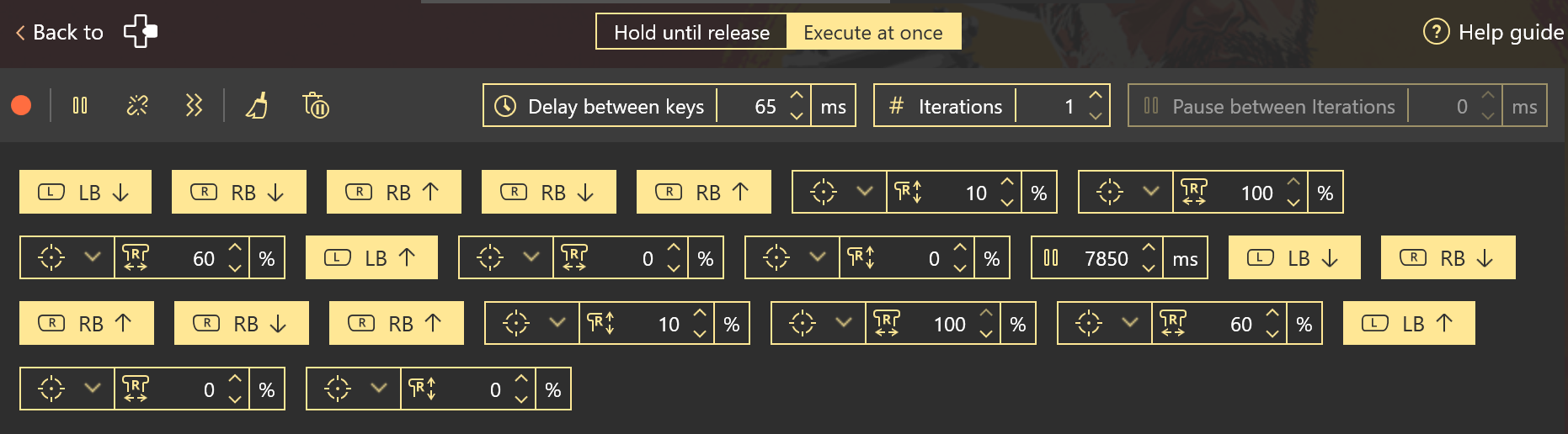

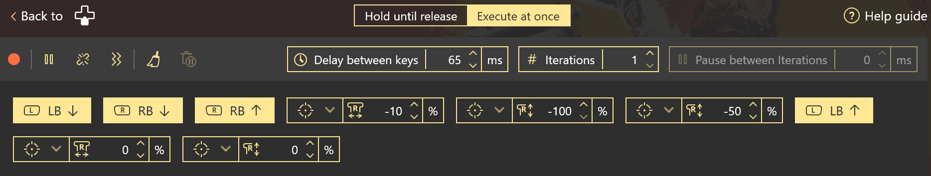

      This config has 4 gamepad sub-configs. Can you please explain how many controllers you have grouped up and what are they? And what combo does keep [RB] pressed?

        I have a group of 4, Xbox elite 2 + dualshock 4 + 2 regular xbox one gamepads, the combos with RB trouble are in the attachments

          Thank you for the info.
          I have tried to reproduce the same issue (with Xbox Elite 2, DS4 and other devices in the group), executing the combo from the physical Elite 2 controller — but it works as expected on my side.
          I have applied a config from Android app too, same results. Here is the video, it shows how the combo works in the gamepad tester (it has a long pause in the middle as I can see), still both bumpers are released: https://recordit.co/TJp6tuW390
          I am not sure why the issue happens on your side, but I would be grateful if you clear the data in reWASD and try again. Here are the steps:
          1. Go to Preferences (a gear icon at the bottom right), General tab
          2. Click Clear data button and confirm your action
          3. Wait until the GUI and tray agent appear
          4. Initialize your devices from scratch, create a group and apply your config again
          If it doesn't help, could you please clarify whether you see the same issue in the tester or it happens in the game only?
