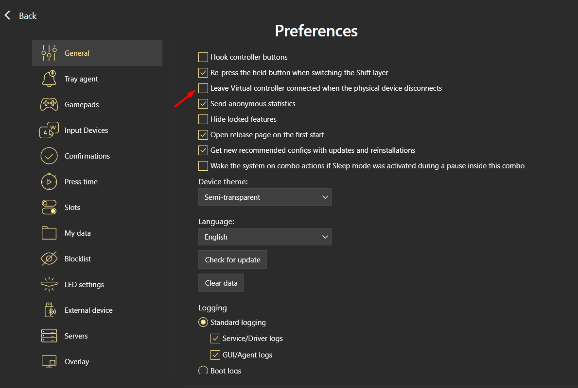

              Great update as usual! One thing that may be an issue; "Do not lose your gamepad once it is disconnected", this seems to function by keeping the remap active even when turning the physical controller off. Is there a way of going back to previous behaviour, where turning off the controller would also turn off the remap (and turning the controller on again would also turn ON the remap)? Thanks for all your work!
              We have released update 6.3.1 where this feature can be disabled in the Preferences.
              • #22
                Wow, great! Works perfectly Thank you
