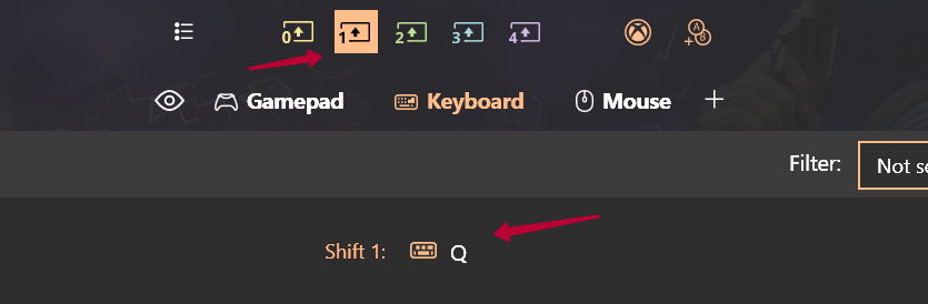

            You need to set Q as a modifier:
            ... and then you need to set Do not inherit to all keyboard keys and mouse buttons (the mouse directions are not inherited). Here is an example: https://recordit.co/2JIscs1GOa (Toggle is optional and is not required in your case).
              Im guessing it didnt save my current settings to the file i uploaded then, because I already have Shift 1 to Keyboard [Q] like you posted in the screenshot. I also shouldnt have anything in shift 2, all it should have is the Keyboard Config on Shift 0, and The Mouse config to Shift 1. Then holding Q i will be able to use Shift 1 (mouse configuration) until i let go of Q. It doesnt matter if the keybinds inherit or not, im fine with whether they do or not

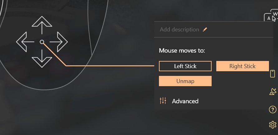

                        1. Please add Unmap to the mouse (inside the Shift):

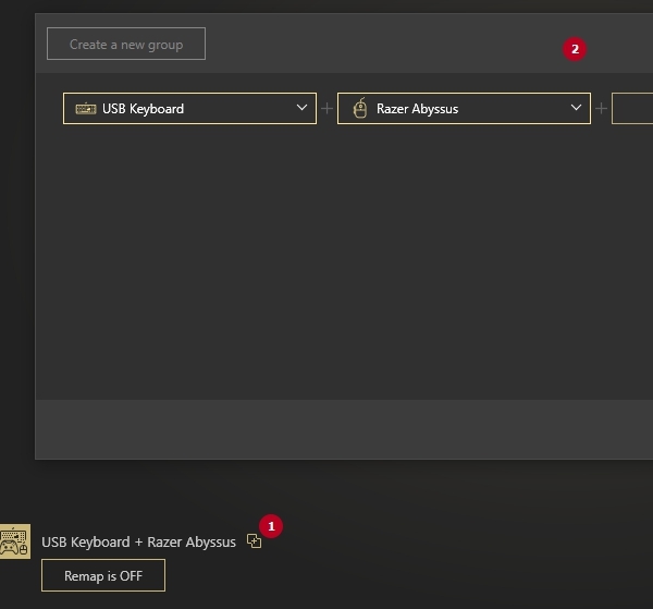

                        2. It may be a chance that something is wrong with the device initialization. Please show me your group, like here:
                          Yeah, i did notice that myself afterwards, but that wasnt the problem either. Im not sure what the problem was, but for some reason Shift 1 wouldnt work with any keybind, but Shift 2 did. so I just transformed everything from shift 1 to shift 2, and used that instead. So i guess its a temp fix.
