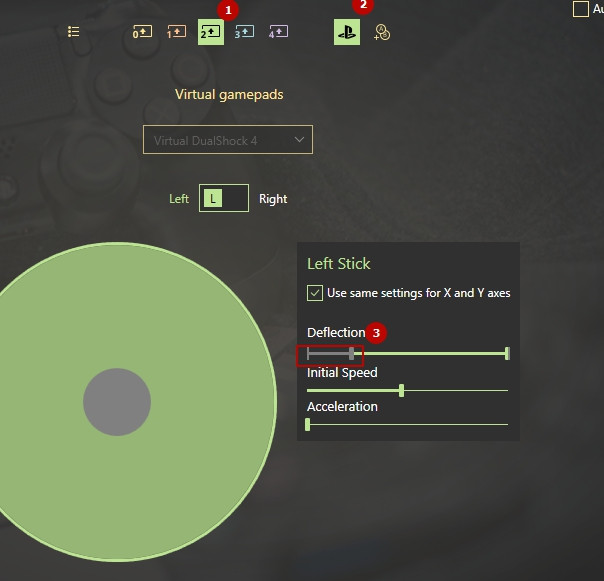

    I think you need to increase the initial deflection of the emulated stick in aiming mode.
    Please follow these steps:
    1. Go to Shift modifier (1), it is a right mouse button — the one you use for aiming. Set it as a shift modifier.
    2. Go to Virtual controller settings.
    3. Increase the Initial Deflection (the grey zone)
    In this case, the stick will be deflected more, so we can override the in-game deadzone that is usually much bigger in the aiming mode.

      Hello, is there a way to have a delay on the shift modifier? The way you mentioned kind of works but for microadjusting aim it feels weird. I want to make it so after I press the ads key, 250ms later I want my sensitivity to change to a higher sensitivity.
        Unfortunately, there is no delays for the Shift modifiers. You can either go to Shift mode when you press and hold the modifier or toggle it.
