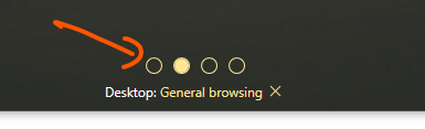

    #3. The meaning of these two are kind of confusing. They seem related, but the dropdown doesn't seem to do anything when you change it. Maybe add a label next to them or at least a tooltip?

    Bottom switcher:

    #3. In the top left corner of the app, you choose a Slot TO WHICH the chosen config should be applied. In the bottom center, you can switch among ACTIVE slots. So, you need to choose a slot at the top left first, when you apply a config, and then you may see or activate it at the bottom center.

      #3. So maybe just have the switcher at the bottom, where you can change the active slot and if you want to change which config will be used on current slot, just click on the config names to the right of the Apply button? Then just click Apply to assign the config to the current slot and save everything. IMO, this will be easier to understand for non-programmer people. When you press Apply near the slot dropdown, it looks like it does nothing and takes a bit of time to figure out what that dropdown is actually for.
      At the very least it should somehow mention what that dropdown does.

        #3. I think I see how we may combine our logic and your suggestion. We need to bind dots at the bottom and list at the top, so when you change an active slot, it changes in a list too. I think it is quite possible, but won't promise anything without some more research
