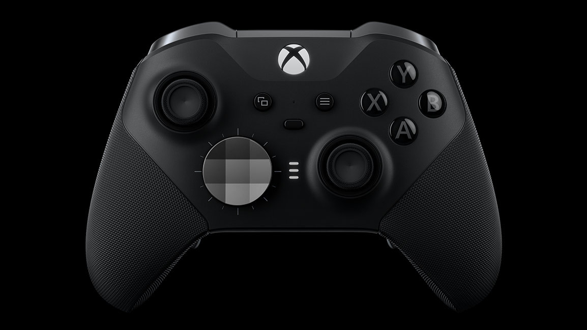

      Re: 2) - I'm using the "XBox Elite Wireless Controller Series 2"
