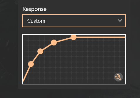

        Seems you have found the closest solution we have now: using Shift mode allows you to set different curve that will be active when you press and hold the trigger.
        However, you can't set a zone as a modifier, so the only thing you can do is to set one different stick curve for one Shift.
        I suggest you to make a pretty drastic curve for the Shift mode, something like this:
        With this curve, your stick will go to max value even if you pushed it on the half distance only.
        There is no way to add a customized script at the moment, so I suggest you to check this option to see if it works for you.
