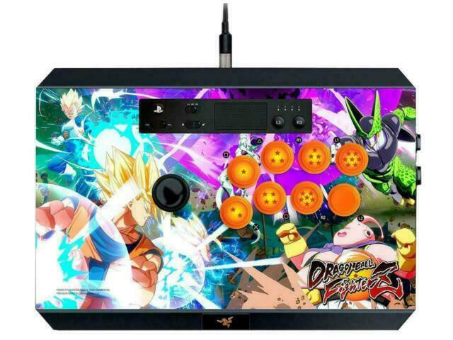

    It's a fight stick that's essentially a ps4 controller. Even has a touchpad. I tried seeing if reWASD would read it, but was unsuccessful. Steam surprisingly reads it as a ps4 controller rather than an xbox controller.

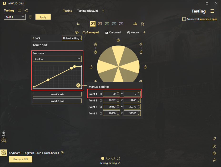

              I have another question. Is there any way I can set the Y or X axis to 0 when using the touch pad? I like to use to move it horizontally only without no vertical inputs.
                If we're talking about a laptop touchpad, reWASD has no means of completely ignoring one of the two axises, but it is possible to minimize [Y sensitivity] to have a similar effect. If you don't mind having about a 10% deadzone on a virtual gamepad stick, you can set a custom [Response curve] like this to almost cut out Y axis:
                Click image for larger version  Name:	image_2020-12-29_045651.png Views:	0 Size:	504.0 KB ID:	223189

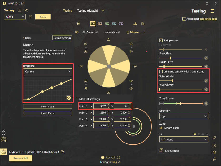

                In case of mapping DS4 touchpad to a mouse, same thing applies - [Y sensitivity] goes to minimum (1), but first point of [Custom Response curve] goes to 20x0 like this:
                Click image for larger version  Name:	image_2020-12-29_051107.png Views:	0 Size:	506.3 KB ID:	223190
                You can change that values as you see fit, but value over 100 would barely register anything.

                    Hey, Dexterso , one more question, could you link us to the device you're using? I'm looking for a proper full name, is it Razer Panthera Evo / Razer Panthera Evo Arcade Stick?
                      I believe it's just Razer Panthera. The Evo is the later version that came out with a different design. Here's the link where I bought mines from. https://www.tecobuy.com/en_US/razer-...-and-pc-3.html
                        Razer Panther Arcade Stick*
                          Thanks!
