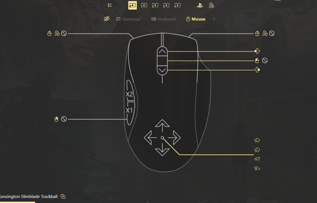

    That gave me an idea, that I'd be able to use the trackball as a whole as some kind of 3-way stick for games! :P, moving the trackball as 2 axis, and rotating the ball as an additional axis, and for almost everything, I think it should work, here's my config:

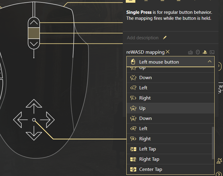

    there's only oneee small problem, I can't set the scroll wheel to mouse movement or to stick movement even, I dont know the reason, but it does not show up when I try to map the scroll wheel buttons

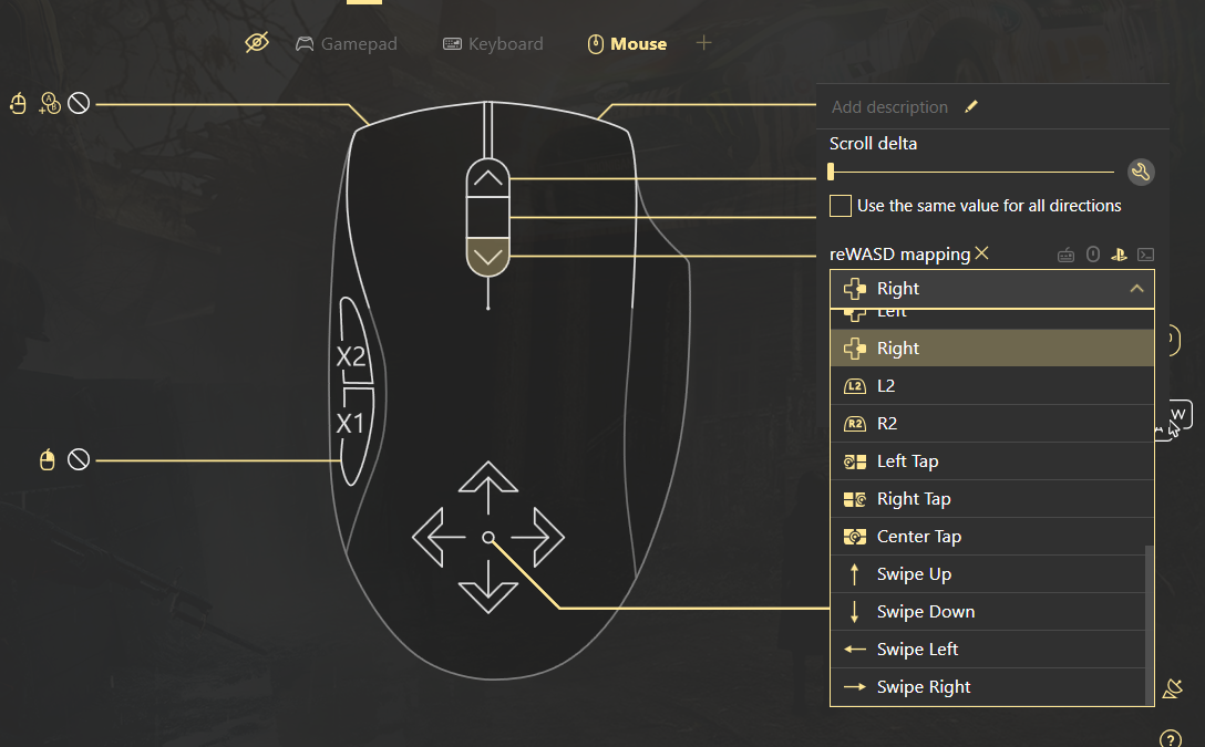

    what makes it weirder to me is that if i pick any other button (like the middle mouse button) its there!

    Scroll up/down events are a bit different from normal buttons: you can hold a button, while you can't hold a scroll. Scroll is always a "repeating" event, which doesn't go well with sticks or mouse movement, whose mappings are designed with "holding" in mind. So the thing you want to do won't be possible as it is for now. But I'll note it as a suggestion, so you might see the change in one of the future releases.
    Though if you can make "scrolling" on your mouse to work as some kind of button via its native software, your goal might be achievable right now. This article should explain the mechanic.
