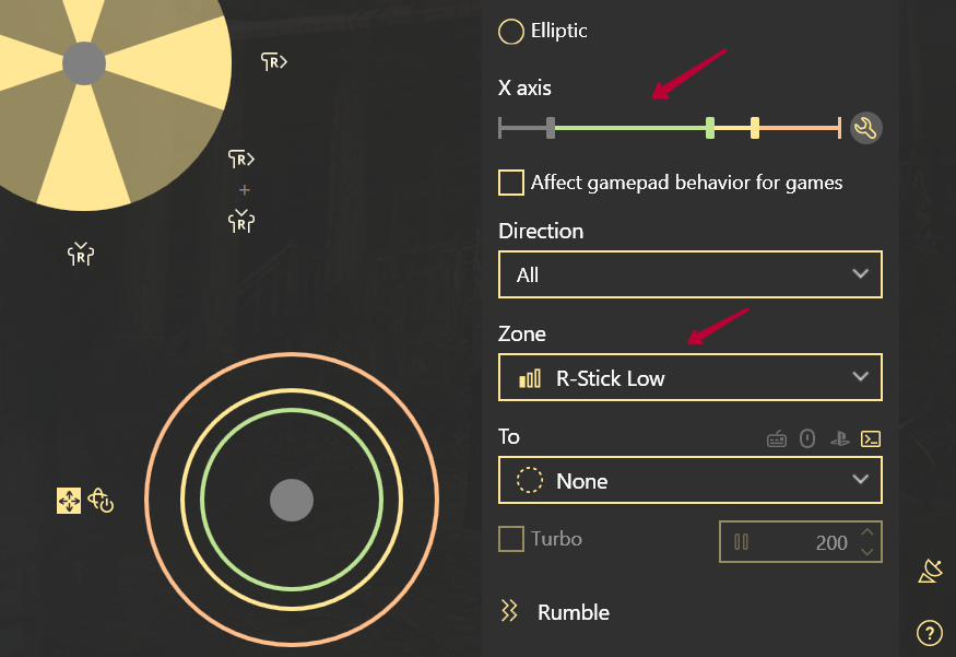

    With a Stick, the idea with zones will work too if you map a command to the Low zone (and it is better to make it a bit bigger):
    With this setup, your gyro will be working until you start moving a stick — gyro off will be triggered then. And when you release a stick, it will go to the Low zone again, and the gyro will be turned on again. Could you please try this workaround?
      I tested this method early, but it has a problem: very often gyro do not correctly turns on after I control the camera by a stick and I need to touch a stick twice or thrice to reactivate a gyro. And thats why I requested split for the gyro turning on/off or add a new function 'use a camera stick -> gyro is off'.
