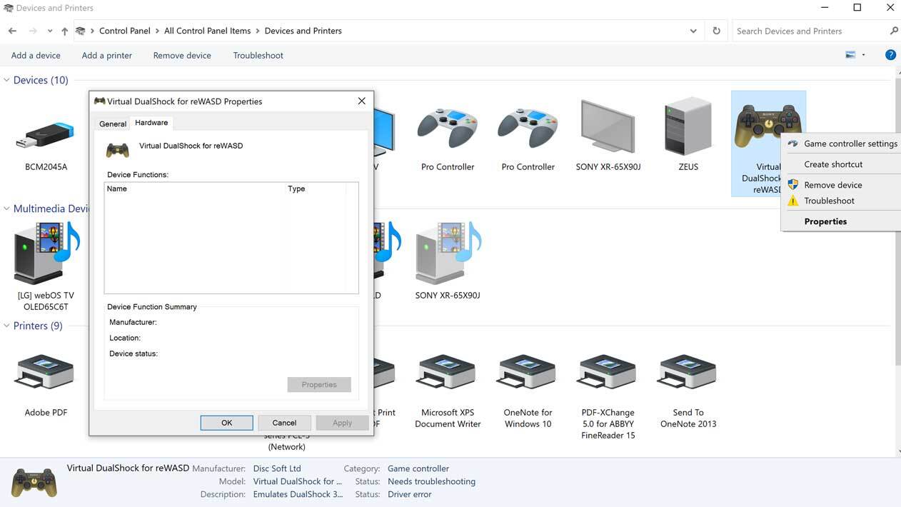

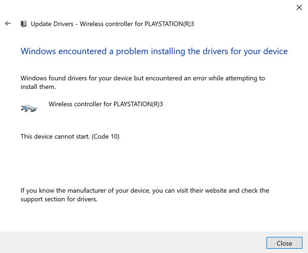

                        By default my Virtual DS3 uses driver steamxbox.sys by Valve (probably cause I have Steam installed). This gives me pressure sensitive buttons in RPCS3 but no gyro. If I try to change driver to sisaxis by Sony, Windows gives me "Windows encountered a problem installing the drivers for your device" and "This device cannot start. (code 10)"
                        I tested this with real DS3 and Nintendo Switch controllers

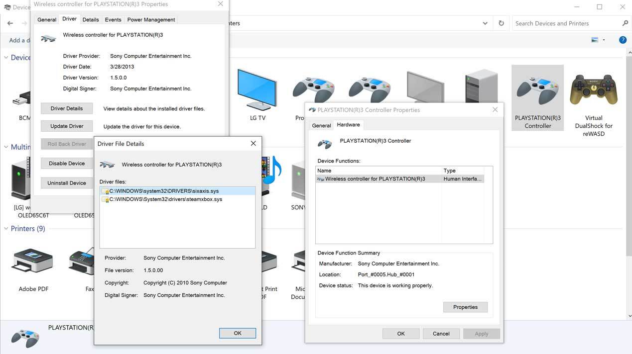

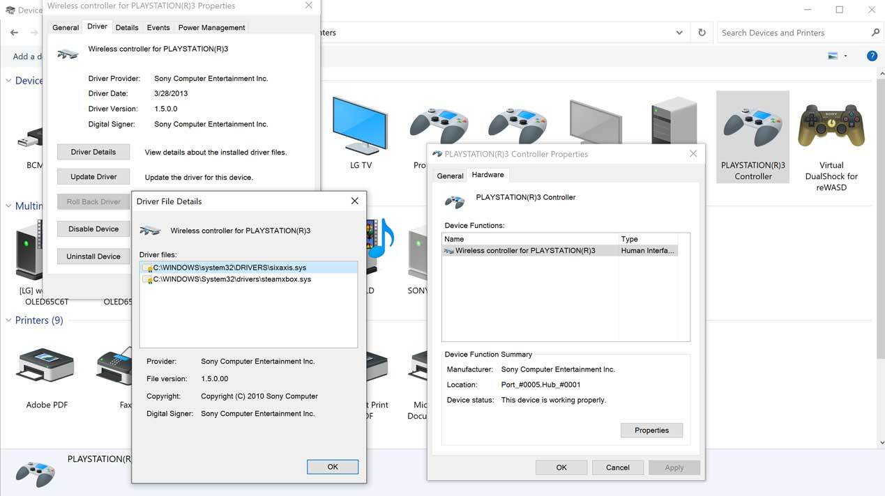

                            Nope, didn't work. Removing steamxbox.sys using DriverStoreExplorer screw up all my input devices after restart, including wireless mouse and keyboard (got Code 19 on them). Took me hours to figure how to restore steamxbox.sys.
                            Thought my sixaxis driver was bad ... but when connecting DS3 using cable, Windows used sixaxis driver on it.

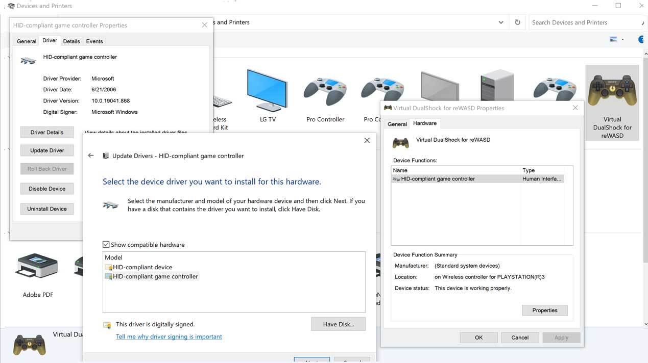

                            Might be worth mentioning that when I install sixaxis driver on Virtual DS3 ... I am "forcing" it: sixaxis is not listed under "Compatible hardware" ... so i have to untick "Compatible hardware" in order to select sixaxis ... after which Windows warns me that "this is not good idea" ... and I get Code 10 as I mention above

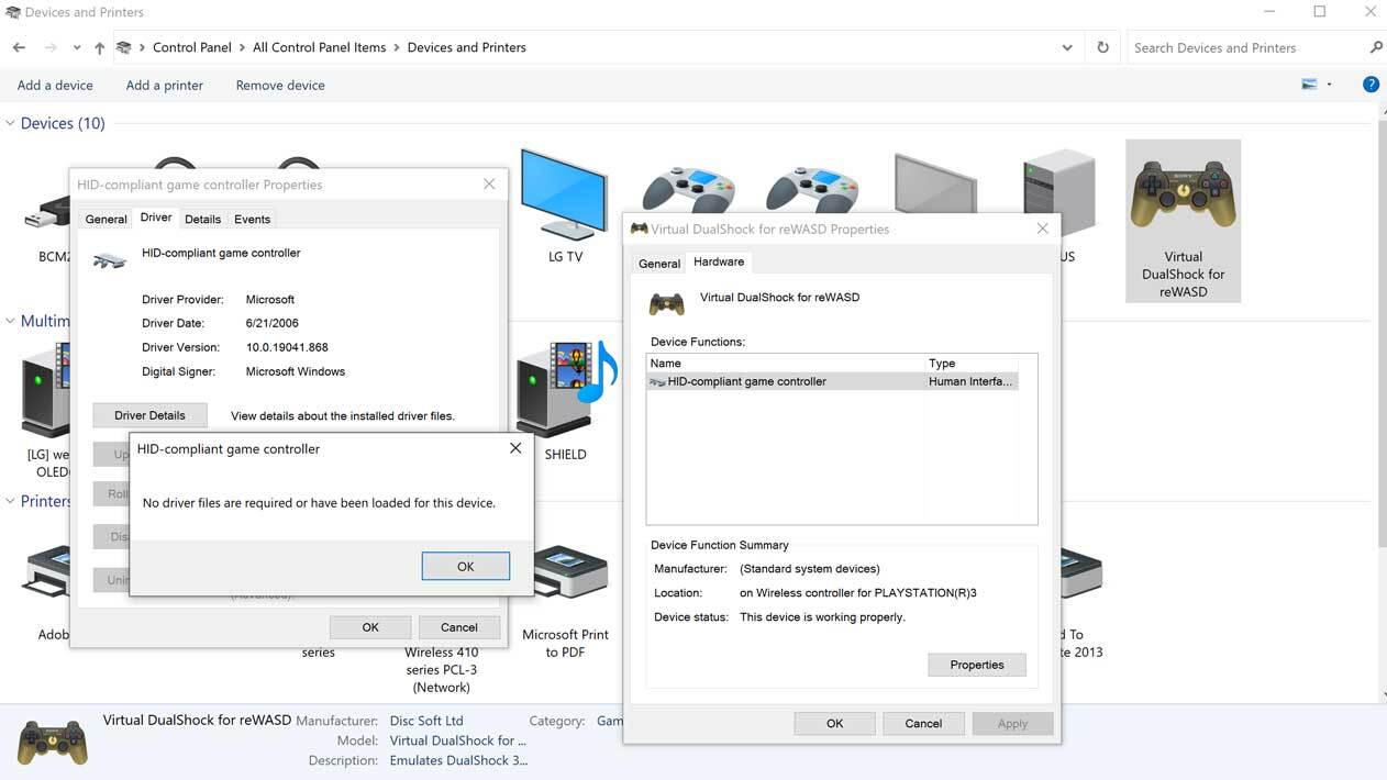

                              OK ... turn out steamxbox.sys is Enhance Xbox controller support in steam ... switching that off - get rids of steamxbox.sys in Virtual DS3 controller ... it is now defaults to HID compliant controller that require no drivers

                              when updating driver to sixaxis this time (have to "force" sixaxis as it is not listed under "Compatible hardware" again) ... on reboot, still does not work
