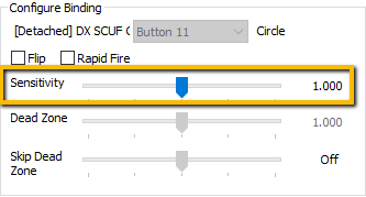

Light Press = Single activator. Firm Press = Long activator. Also, it is better to set a smaller Long Press time in Preferences -> Press time tab, and you will get the following:
