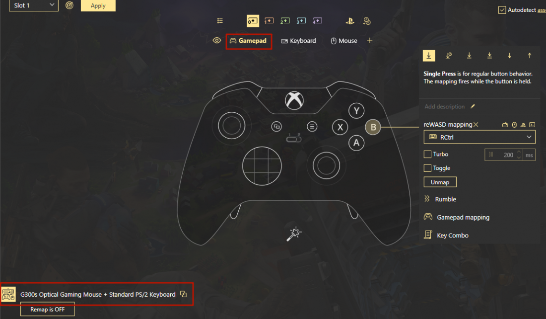

    Hey!
    You can edit configs for the controller when it is disconnected. In the screenshot, only the keyboard and mouse are connected, but you can select a controller and assign mappings to it and then apply this config to it when it is connected.
    Click image for larger version  Name:	157fb712c5.png Views:	0 Size:	604.3 KB ID:	225920
    Without a controller connected, the image will always be Xbox One Elite, but this will not prevent the config from being applied to DualShock.

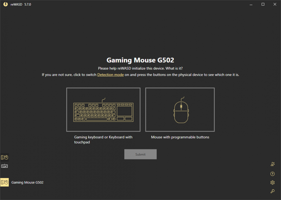

      In my case, the application looked like this:

      I didn’t see the controller, so I thought there was no way to configure it.
        You can select the keyboard at the bottom left to open such a window, as I showed in the screenshot above.
        Also, your mouse is not configured. If you want to set it up for remap, then follow the steps described here in the paragraph Remapping a mouse with programmable buttons.
          Hey there! You can go to the config when the active device is ready to be remapped. In your case, you have a mouse that is not initialized. Please choose it as a mouse, and then you will see the list of profiles at the top-right that is active. You will be able to edit the config, just be sure that you choose the gamepad (not a mouse) next time you connect the controller and will be ready to Apply it.
