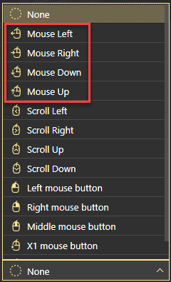

                    Do I get it right: when mouse is being moved, you want reWASD to press a button on controller or when a controller button is pressed, you want to move a mouse pointer?
                    For first one you'd need to map a [Mouse Zone] to a controller button. Option available at [Advanced mouse settings].
                    For latter - these are the mappings you're looking for:
