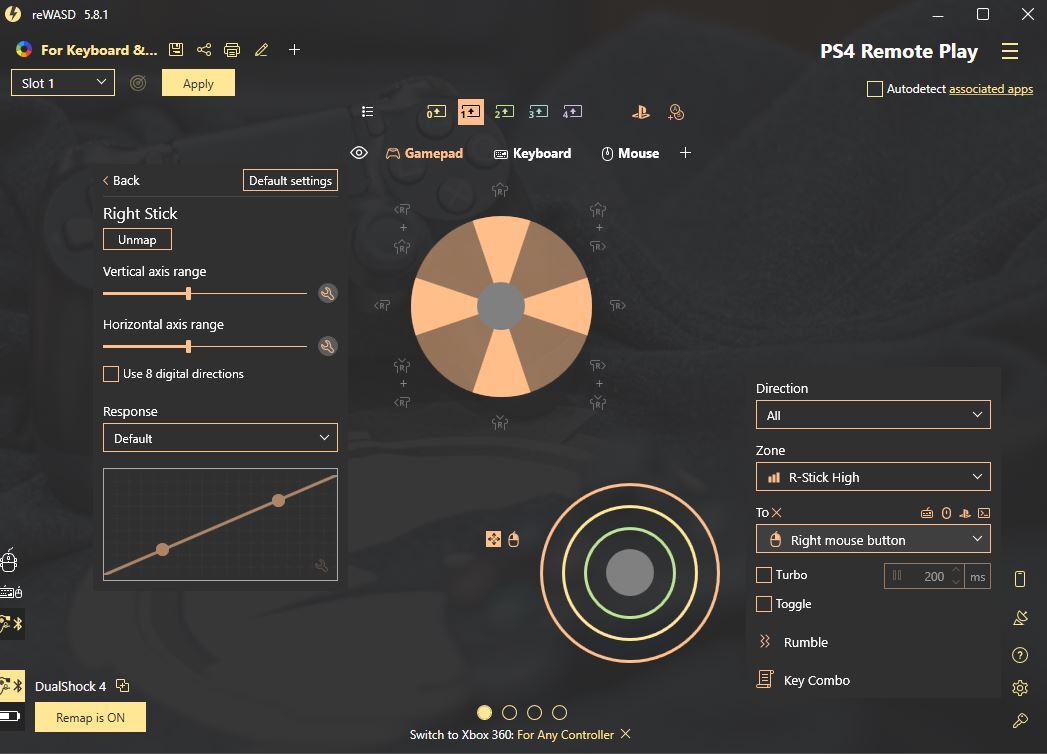

      this is a little problematic because there is no way i can find to adjust the zones for the playstation thumbstick. i essentially want a mouse click after moving the thumbstick as it is required to switch between keyboard and controller in game- id rather not have to press each mouse button twice after moving.
        turns out mapping zones doesnt show up during shift... having a message would make this less confusing.
          The attached file is a screenshot of advanced mapping settings inside the Shift1.
          There is absolutely no issues with adding mappings for the mouse presses.
          In my case, the mouse is being pressed once as soon as you reach the high stick zone, but you can add the key combo of double-right-click if you wish. Works flawlessly as well
            Am I right that you want to have this mapping only when you release the stick (when it returns to the deadzone)?
            In this case, zones may not help you fully, because the zone mapping is emulated while you are inside this zone. Still, it is an interesting suggestion, I think we could consider it for the future versions.
