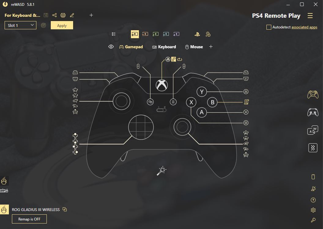

    There is always a possibility to edit the config and it's mappings, as you are editing the config file, not the controller itself. Just select any other device, then select the config for another controller, swap to the gamepad tab and adjust the mappings correspondingly.
    Some buttons will be missing, as we use Xbox One\360 as a standard layout and you can edit the default layout of the controller only.
    As you can see on a screenshot attached, I have selected mouse, but still can edit the config for the controller.

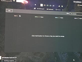

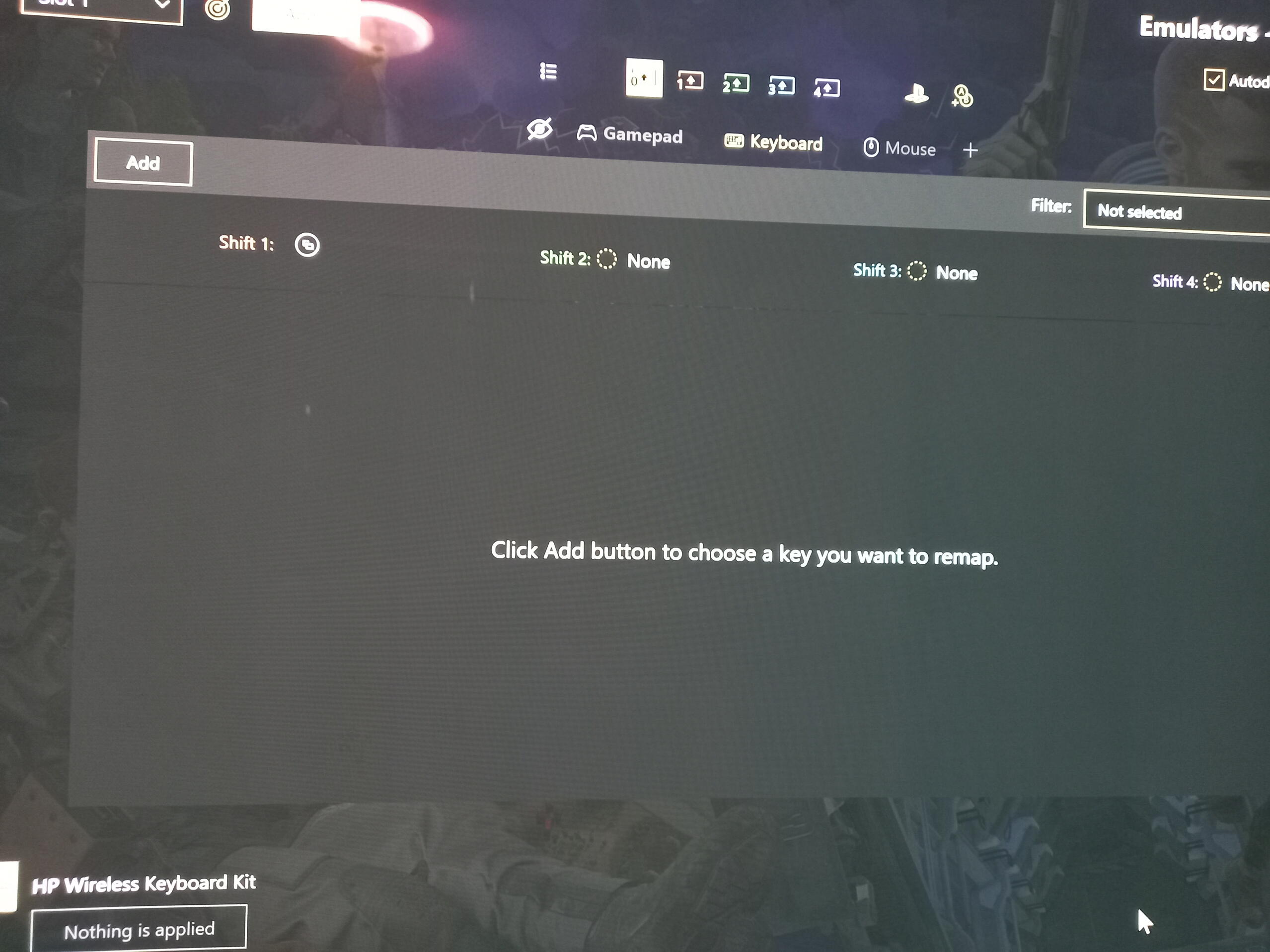

          Did not work for me ... my keyboard and mouse are HP that connects to PC via one dongle ... ReWASD group it as HP Wireless Keyboard Kit ... so i dont habd separate mouse icon
            The [Eye] icon is crossed on your screenshot. Click on it so it would change to clear [Eye] icon. That will allow you to change other sub-configs.

              Now ... that worked
              Thx
