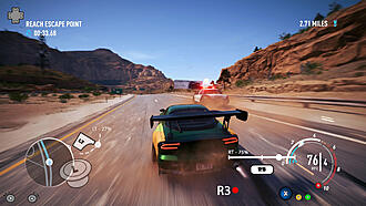

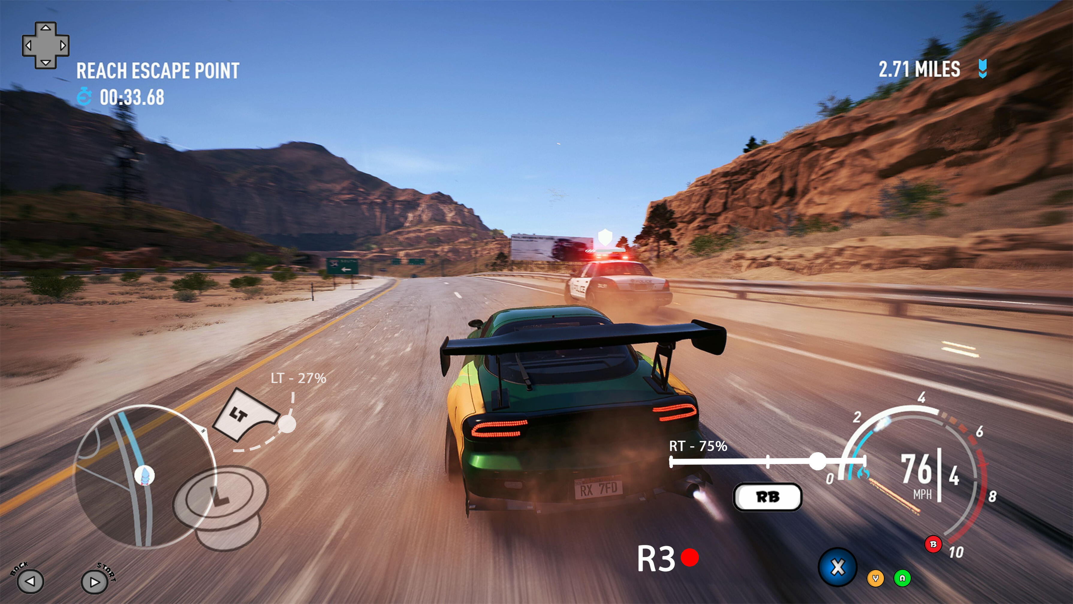

        No, I meant displaying either the entire gamepad, or displaying its individual elements (buttons, sticks, triggers). In the second mode, each element is drawn separately and can be arbitrarily positioned and scaled. Also, separately for each element, you can set the transparency and display option: a button icon, a scale, or a simple indicator.

        I tried to sketch my idea The main idea is that interfaces are very different in games. Placing controls separately on the screen in the right place can increase readability and informativeness during gameplay.
