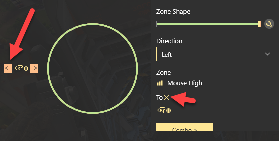

            Go to [Advanced settings] of your mouse mapping and remove [High Zone] mappings by selecting the square at the left and clicking [X] at the right.

              Now yes! It has improved a lot, I have more control of the aim than before. Is there any way to improve more than that or is it the most that can be done?
